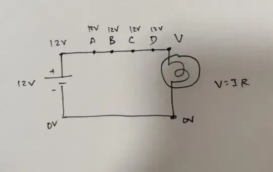

If the potentials at points A,B,C .. etc are at the same potential as the battery wrt the ground, how does current flow then?
I'm lacking something fundamentally so it would be helpful if someone could correct my mistake.
Also where exactly does the voltage drop occur(from 12V to voltage across the bulb)? Does it occur immediately when the bulb's terminals come in contact with the wire or does the 12V gradually decrease till it reaches the voltage of the bulb?
Moreover, if I were to measure the voltage at any point in the return path (after the bulb) how would I measure that? What would be my "ground" or "reference to measure the voltage against" in this case?

  • It takes some time for the voltage across the bulb to reach its final value. This time taken can be as small as microseconds or as large as a couple of seconds depending on the bulb. – nidhin Aug 07 '19 at 14:49
  • PCB foil is 0.000500 ohms per square (for standard thickness 1.4 mils, the default 1 ounce per foot^2) for ANY size square. Thus a trace of size 0.01 inches wide by 10 inches long will have 1,000 squares and be 0.5 ohms. At 1 amp drawn by the bulb, the trace will have by Ohms Law V = I * R, or 0.5 volts between the ends of the trace. Thus zero is not zero. – analogsystemsrf Aug 07 '19 at 16:04
In real life, the points are not exactly at the same potential, since wires have some very small resistance. However, for many situations, it is fine to consider the wire having zero resistance, which means that electrically, points A, B, C, and D are the same voltage because they are the same point. More precisely, they are all the same node.
If you want to, you could consider the case of the wires having some resistance, and then take the limit as the resistance approaches 0 (if you are familiar with the concept of limits). By Ohm's law, you have \$V = I\times R\$, but when R equals 0 and V also equals 0, you have \$0 = I \times 0\$, which actually has an infinite number of solutions for \$I\$, any value can work.
Regarding your second question, the 12 V is ideally dropped entirely across the bulb itself. The voltage at the top terminal of the bulb is 12 V, and the voltage at the bottom terminal is 0 V.
And for your third question, you can measure the voltage along the return path relative to another point on the return path. It will be very close to 0 V unless the wires are long enough relative to their resistance. You would just need to define where the ground is. For example, you could say "the voltage at the low side of the bulb is 0.03 V higher than the voltage at the battery negative terminal".

In terms of cause and effect, the battery voltage is the only source of power here, so take that 12 V across the battery as a given. Everything else happens because of that. Now, whatever is connected between the battery terminals will have 12 V across it, and current will flow based on Ohm's law (for a resistive load like this one). One possible flaw in your reasoning is that current doesn't actually need to flow for a potential difference to exist. If you break the circuit anywhere, a 12 V difference will be across the break, though no current will flow. There would be 0 V across the bulb.
In this circuit, assuming the wires are low-valued resistors and the bulb is a high-valued resistor, Ohm's law applies because of the material properties of the elements. So V = IR, but the cause and effect relationship here is that voltage is causing current. It would be the other way around if you had a current source instead of a battery/voltage source.
All that being said, though, for introductory homework problems they usually want you to assume that all wires have exactly zero resistance and are a single electrical node. This circuit would be the same as connecting the bulb directly to the battery with no wires.

  • Ok so, the points A,B,C,D are not at the exact same potential because of the potential drop after each point, right? Now my question is, a potential drop occurs when current flows through that particular point. What I'm confused about is, potential drop exists hence current flows, but a currentneeds to flow for a potential difference to exist. This sort of seems like a paradox to me, can you please help? – penguin99 Aug 07 '19 at 14:22
  • @noorav - Answer edited to talk more about cause and effect – Justin Aug 07 '19 at 14:40
  • Thank you! Also is the potential right at the negative terminal of the battery = 0v or something? (wrt ground) – penguin99 Aug 07 '19 at 14:42
    @noorav - Voltage is always measured between two points. Ground is not actually a real thing. Putting a ground symbol on your schematic is just a way to say "I choose to call this point 0 V", but you can actually put it wherever you want. A typical place to put it is on the negative terminal of the battery. The reason to define a ground point for your circuit is so you can say "the voltage at node A is 12 V" instead of saying "the voltage at node A is 12 V higher than the battery negative terminal" all the time. – Justin Aug 07 '19 at 14:44
  • There are different considerations for appliance/safety/earth grounding, but those are related to safety and don't change the way current flows. – Justin Aug 07 '19 at 14:47
  • please tell me if my understanding is right. So basically point B is at a lower potential as compared to A, point C is at a lower potential compared to B and this is why current flows from A to B to C and all the way through the whole circuit. Now my question is, what makes point C at a lower potential than point B or point A? A voltage drop right? But the voltage drop occurs only if current flows from A to B. But for the current to flow, there has to exist a voltage drop. This whole situation seems paradoxical to me. Can you please clarify this? – penguin99 Aug 13 '19 at 14:03
  • @noorav - I've added some more to my answer. – Justin Aug 13 '19 at 18:01
  • @noorav - I stumbled across another question with some very good answers that might help you too: https://electronics.stackexchange.com/questions/19759/how-does-the-current-know-how-much-to-flow-before-having-seen-the-resistor – Justin Aug 15 '19 at 20:11
The largest part of the voltage drop will occur along the filament of the bulb.
If you were to measure ON the filament you would find that one side is 12V, the other is 0V and if you measure in the middle you will find 6V.
However, your assumption that points A, B, C and D are all 12V is incorrect. Wires have resistance (unless you are working with superconductors) and there will be a slight drop in voltage across the wire. but it should be very small in a well designed circuit, because wherever there is a voltage drop and a current flow there will be power lost to heat (good in the filament, useless in the wires). A might be 11.999999, B 11.999998, C 11.999997 and so on.
As for measuring the 0V wire...
To measure any voltage you need to choose a reference. There is no correct/wrong choice but in your case to best understand the circuit your reference should be close to the battery - connection.
If you were to measure the 0V wire at various points using a high precision instrument (or using really thin wires) you will find that voltage increases as you measure further from the battery, much like the 12V wire voltage decreasing as you get further from the battery.
Current flows from - to + (because electricity is movement of electrons, which are negative) and will flow wherever it can, much like pressurized air/water will flow through a network of tubes to wherever it can.
  • Ok so, the points A,B,C,D are not at the exact same potential because of the potential drop after each point, right? Now my question is, a potential drop occurs when current flows through that particular point. What I'm confused about is, potential drop exists hence current flows, but a currentneeds to flow for a potential difference to exist. This sort of seems like a paradox to me, can you please help? – penguin99 Aug 07 '19 at 14:26
  • The difference between 11.999999 and 11.9999998 occurs because of the current flowing through that tiny bit of resistance right? But for the current creating this difference to flow, there should exist another different potential difference right? Sorry but I'm really confused about this.. – penguin99 Aug 07 '19 at 14:27
  • The original difference is produced by the battery, much like a water pump circulating water in a closed system. For visualization only: When electrons gets "pumped" by the battery a difference in "pressure" becomes present at the battery terminals. Negative at one side, positive at the other. Electrons will "push" and "pull" on their neighbors and this spreads through the system eventually leading to a current/flow. There will always be a difference in pressure produced by the pump and this creates a pressure gradient (voltage drop) through the system, biggest where resistance is highest. – Ronald McFüglethorn Aug 07 '19 at 15:42
