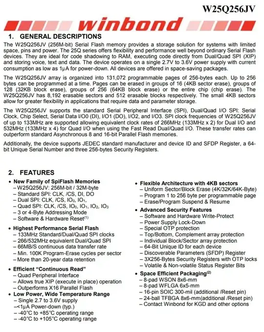

I am trying to understand the terminology used for various non-volatile memory chips for example as EEPROM and Flash.
EEPROM Features Flash Features
Is there any preference to use the word EEPROM or Flash for specific type of memory chips or is it some specific technology difference in the two types?
