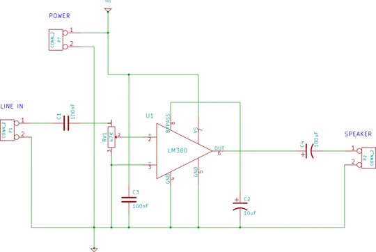

Here's my proposed circuit (I'm learning KiCAD, so it's not all that great; apologies in advance for the vertical labels!) if it helps answer the question:
Also, regarding capacitor polarity: I'm assuming the output AC coupling capacitor can be a regular polarized capacitor, even though the charge of the capacitor and inductance of the speaker will temporarily reverse the effective potential when the output goes close to ground in a waveform swing?

First of all, the output coupling capacitor will never go negative. The speaker will, but the capacitor won't, and that's one of the reasons it exists at all, to provide a dc offset so that the amplifier doesn't have to go negative in order to drive the speaker negatively with respect to ground. It needs to be large enough so that it doesn't get charged/discharded too much during voltage swings, which would distort the audio signal.
Secondly, the datasheet includes a schematic on page 2, and you can see exactly where the bypass capacitor goes. I'm no audio expert, but I can see that it is basically part of an RC low pass filter to power/bias the differential stage of the amplifier, so it basically isolates it from power supply fluctuations. A side effect is to partially separate the dc bias current setting resistor from the open loop differential gain setting resistor of that stage.

    Thank you; great answer! But if the speaker is swinging high, and the amp output goes to ground, why doesn't this put a negative voltage across the output coupling capacitor? Or is it just a negative current, and the actual potential never reaches negative? – Jon Watte Oct 20 '12 at 08:07
  • @Jon The cap will get charged to the average amp output, which is Vdd/2 in this case. Then it will basically just "ride" with it, and the charge/discharge should be minimal because its impedance should be small with respect to the load at audio frequencies. In other words enough current doesn't flow for long enough for the charge displacement to represent a significant voltage change. – apalopohapa Oct 20 '12 at 09:07
    Also, the speaker shouldn't swing on its own, the purpose of this circuit is to drive and reproduce the input signal as sound. Being essentially an inductive load, it will have "inertia" in current, but not in voltage. The main point being that the voltage at the inductor will basically be the amp's voltage, ac-coupled by the cap, which essentially removes the dc component (Vdd/2). – apalopohapa Oct 20 '12 at 09:24
