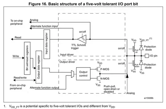

The pull up/down is only effective in Input or Open Drain configuration.
When set as output there is always an output MOSFET active, the pull up/down is then wasting energy.
The exception is open drain mode, this disables the P-MOS, then pull-up can be useful again.
Figure 25. Basic structure of a five-volt tolerant I/O port bit
