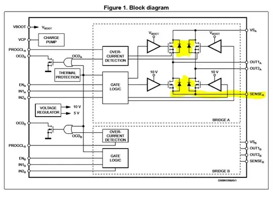

We're building a motor-drive circuit using an L6206 dual H-bridge circuit. The bottom side of its H drivers come out of a pin called \$V_{sense}\$, intended to be connected to ground or to a low-side current-sense circuit. I'm expecting to drive motors with PWM up to an amp or two.

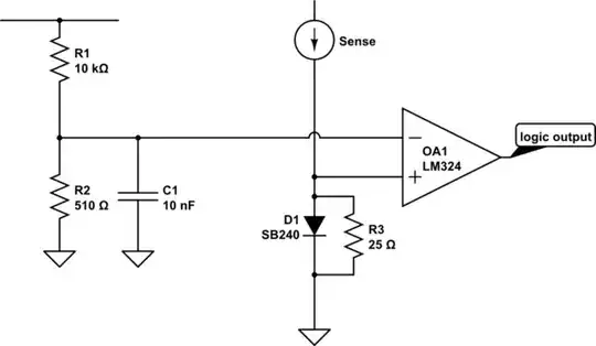

I want a logic sense line to indicate whether there's any current flowing (say \$>10mA\$), or not. It's essentially detecting the operating presence of the (removable) motor.
I think I can do this by comparing the voltage drop across a Schottky diode with an approx \$0.25V\$ reference. I'm thinking of using a divider to create a weak \$0.25V\$ voltage source from my \$5V\$ power supply, a \$2A\$ Schottky diode (eg SB240, \$V_f=0.5V\$ at \$2A\$) with a small \$25\Omega\$ bypass resistor to eat any leakage, and a comparator (eg LM324 op-amp, or LM339) to create the \$5V\$ logic result.
schematic
Wherever I have looked up designing current sense circuits, there is always a low-value power resistor to create the voltage drop. I haven't found any that use a diode. I think that a Schottky diode is perfect: its voltage drop will clamp off nicely so it won't waste heat, it's cheap and simple.
Perhaps everyone else is interested in measuring the current level, where I just want to know if there is a current at all? Or, they only care about being close to a maximum current, where I want a minimum?
Why don't I see any diode-based current sensors?
Note: my logic output essentially goes into a latch, so I don't care that the signal will flap around with the PWM.

    It’ll certainly waste more heat than a low impedance resistive current shunt and amplifier and, it won’t be linear. Sounds a bad idea to me. – Andy aka Jul 27 '19 at 16:16
    You could reduce the bypass resistor from 25 to about 2 ohms (using a cheap comparator whose offset voltage is 10mV, sensing your 10mA decision point). Yes, the diode will clamp on big currents - its a design decision: is diode cost worth the efficiency increase? – glen_geek Jul 27 '19 at 17:17
    @Andyaka Ok, I think I don't want it to be linear - I want it to snap over at around 10mA (give or take) and stay there all the way up. If I use a little $0.2\Omega$, it means I need to detect a 2mV gap for my 10mA trigger: might that be quite challenging with noisy power PWM and motors just next door? and it still drops $800mW$ at the max 2A, about same as the diode. I can make the resistor lower, but the sensitivity requirements get harder... – SusanW Jul 27 '19 at 17:31
You can choose the resistor so that it consumes the same power, or less if you want to. At 2 A the diode will consume 1 W, so "equal" resistor would be 0.25 Ω. At smaller current, say 1 A, the diode will consume roughly 0.5 W because the voltage doesn't drop that much. There the resistor only consumes 0.25 W, which is significantly less.
The diode is not accurate. Its \$V_f\$ varies especially with temperature. Junction to ambient thermal resistance is 45°C so you can expect that much heating with the maximum current. And if you have some heating from outside (direct sunlight for example) you can easily reach 100°C temperature for the junction which drops \$V_f\$ to half from the original. A decent resistor drifts something like 50 ppm/°C, so at temperature rise from 25°C to 100°C the resistance changes only 0.375%
With a resistor you do need an amplifier, because at low current the voltage is also low. But there are circuits made for just that, so implementation is not difficult. Search for e.g. current sense amplifier. Some of those even have a built in comparator so the number of components might even be the same as with the diode + comparator solution. And while you are adding an amplifier, you can drop the resistor size, and get away with a lot less power loss than with the diode.
So the answer to your question is, diode based solutions are not accurate, and consumer more power compared to shunt resistor solutions.

  • Your point about the temperature is excellent - I'd thought about whether the heat was excessive but I'd carelessly assumed the effect on $V_f$ to be negligible. And I notice that some current sense amps discuss PWM immunity - interesting. Ok, brilliant - thanks, good answer. I'll leave it a couple of days to give others a voice, but ... yep, thanks :-) – SusanW Jul 27 '19 at 18:17
Using diodes of any form to detect an open circuit motor or wiring is not going to give good results.
As others have mentioned, there are temperature variations to handle for the diode, and using a resistor is difficult when the voltage drop becomes very small.
However more important than any of the above you would have to use a pair of back to back diodes or you will compromise the back EMF handling of the H-Bridge and risk damaging the device.
Notice that the sense line is the bottom of the H-bridge and if you allow the voltage to get too high you may impact the ability to drive the lower FETs. You also need a low resistance path to ground to allow back-EMF clipping to occur.

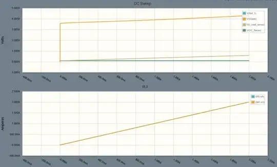

Waveforms would look like this for a 2A span:
In the schematic above:
  1. R1/R2 create a reference voltage of about 100mV
  2. R4 starts the OA1 driving M1 gate
  3. M1 (operating in a linear mode) maintains a 0.1V plateau providing there is at least 100uA current flowing
  4. If there is no current flowing then R4 pulls both OC_Sense and I_Load_Sense low
  5. CMP1 creates an Error signal by comparing I_Load_Sense to the Ref_1 voltage
  6. R5 provides normal load current sense by subtracting Ref_1 from I_Load_Sense
  7. D1 prevents the lower point in the H-Bridge exceeding about 1.1V (probably not required)
Considerably more complex than using a single diode, but provides open circuit detection and current measurements for the H-Bridge.

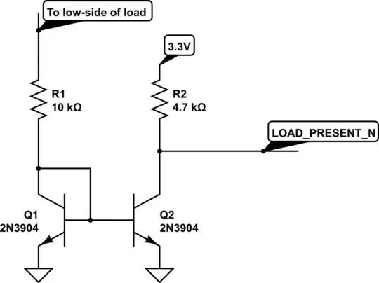

Change the idea. You can insert an active low current pulse circuit to detect if there's a load connected. If the voltage depends enough on the pulses, there's no load.
The request is to see if the motor is plugged in or not, yes?
I faced a similar problem for a product, to detect if a display panel was plugged in. My solution? Use a current mirror to pass a small sensing current into the load, like so:
schematic
Q1 sinks a small current from the connected load, turning on Q2 and bringing signal LOAD_PRESENT_N low. If there is no load connected, Q1 and Q2 will be off, so LOAD_PRESENT_N will be high.
Ideally you want to use a matched pair for Q1/Q2, but for this kind of basic use separate NPNs should be ok.
EDIT: add to the above: a weak pull-up to the load (+) side to complete the low-current sense circuit. The sensing would only be used when the motor is idle, such as during initial power on or during a diag self-test.
Also note that the sensing connections are to the motor, not to the Rsense on the H-bridge low side. You still need Rsense for the error amplifier, and it should be a low value (like 0.1 ohm or so) to minimize power loss.

  • Looks good, but how does this detect 10mA, when the full flow of the motor is up to 2A? I think that $10k\Omega$ is in series with the load, isn't it? – SusanW Jul 30 '19 at 09:29
  • It’s not intended to sense the entire current. It is in parallel with the driver, and works when the driver is ‘off’. You would also have a weak pull-up on the high side of the load. – hacktastical Jul 30 '19 at 15:05
  • Mm, I see ... ok, I have a full H-bridge and the load is reversible, so I guess I could arrange a bridge rectifier around the load. Though (not previously mentioned) I'm looking for a disconnection condition too; I guess I could briefly kill the power, and then sense ... might have to wait for the motor to spin down though. – SusanW Jul 30 '19 at 15:56
  • You don’t need a bridge rectifier. You’re only injecting a small sense current, which you would check when the motor is idle, e.g., at start-up, during some sort of diag routine or when the motor is idle. – hacktastical Jul 30 '19 at 16:09

  • This simply won't work hooking into an H-bridge. You are just measuring the voltage available ,,,,it has nothing to do with whether current is flowing. Draw a more complete schematic to show how you think this would be connected. – Jack Creasey Aug 01 '19 at 02:14
  • The bridge has to be disabled for it to work, which is why it would be a diag-time sense only. There's an EN pin on the driver IC that would allow that. Looking at the other proposals that use Rsense, or as the OP asks, a diode, won't work either. Sometimes the H-bridge will be idle and so Rsense won't be seeing any current. Instead, monitoring loop closure is more typical industry practice. – hacktastical Aug 01 '19 at 02:22
  • Circuitlab is unhappy right now and won't post anything, otherwise I'd be happy to add the weak pull-high to the other side of the motor. I'll try later, maybe. – hacktastical Aug 01 '19 at 02:54
