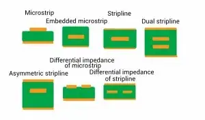

1) It's extra parasitic inductance built into a trace.
2) No, there are many way's to create a transmission line.
Source: http://www.gsm-modem.de/M2M/m2m-faq/transmission-line/
3) Roughly 50Mhz, after that transmission line effects start to take hold.
