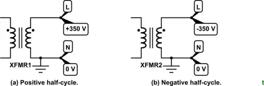

Figure 1. Voltage measurements during positive and negative mains peaks.
The mains voltage peaks at \$ \sqrt 2 \$ times the RMS voltage. For your 250 V RMS supply that will be about 350 V peak. If you had a fast-acting DC meter with max / min peak hold function you would be able to take the readings indicated in Figure 1. Neutral stays at 0 V and the live wire polarity alternates.
If you touch the neutral wire you won't get shocked but if you touch the live the wire you get shocked why and how?
Because the neutral has been neutralised. There is no voltage on it with respect to ground.

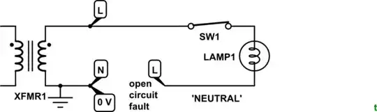

Figure 2. The disconnected neutral wire turns live.
Also be aware that if the neutral conductor breaks and anything is plugged in to the circuit then the neutral wire may go live. Never assume that a mains conductor is at 0 V. Isolate properly.

                    Is figure 2 an example of an incorrectly wired circuit? You aren't normally suppose to wire connections in a series like that right? Precisely due to the risk of the neutral going live. – Nelson Jul 22 '19 at 01:35
                    @Nelson I'd say it's an example of a faulty circuit - i.e one where the neutral wire was broken, or indeed installed incorrectly. It wont work (light wouldn't turn on), untill the neutral is properly connected. What do you mean by "in series" here? This (with the neutral connected) is how it normally is - the lamp and the switch have to be in series, how else would it work? – Jonas Czech Jul 22 '19 at 05:18
                    Oh, ok, that makes sense. The open circuit caused by a broken wire, not someone deliberately putting a junction box there. That makes sense. A broken neutral will definitely shock if someone is stupid enough to grab the two broken wires of the neutral and complete the circuit. – Nelson Jul 22 '19 at 05:25
                    @Nelson: I've added some text to Figure 2 to clarify. Since the transformer secondary is earthed one could get a shock by touching 'NEUTRAL' and earth. The body's capacitance to earth may be enough to shock even without a direct connection. – Transistor Jul 22 '19 at 06:11
                    2@Nelson It's not so much "someone is stupid enough to grab the two broken wires", but an example of what could happen to someone poking around the lamp socket, believing themselves "safe" in the knowledge that "the neutral is at zero volts" ... a break in the neutral anywhere from the lamp back to the distribution panel could expose them to the full mains potential. – TripeHound Jul 22 '19 at 10:54
