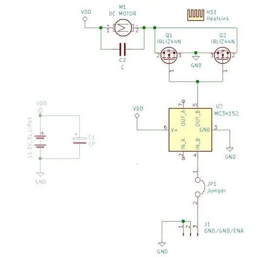

I'm making a PWM driver for a DC motor. After some questions were answered in this post, I ended up with this schematic:
Enter image description here
And I have some new questions:
  • Do I need a resistor between the gate and the output of the gate driver (U?)?
  • Do I need a pull-down resistor at the gate of the MOSFET?

    The simple answer is YES you need a resistance between the gate and the out of the gate driver (U?). I have seen FET's blow up when they had no or too small of a damping resistor in series with the gate. – user57037 Jul 18 '19 at 07:16

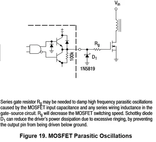

    Datasheets are your friends. |Placing a link to the component datasheets in your question helps people help you. | Gate drive resistor is usually for damping. A value in the 4 to 10 Ohms range is often useful. | Place a reverse biased diode across C2 or in place of it. | See driver datasheet figs 19 and 22. In fig 19, placing the Schottky diode AT the FET with minimum distance often helps damp oscillations. ... – Russell McMahon Jul 18 '19 at 12:14
    ... Placing a reverse biased zener across FET gs also helps. Vzener slightly greater than Vdrivemax. This stops Millar capacitance coupled DG spikes encouraging your FET to self destruct. (Makes a VAST difference to FET longevity in some cases). – Russell McMahon Jul 18 '19 at 12:14

Maybe. The MC34152 datasheet pp.8 on shows a series Rg to damp oscillations, and reverse-bias Schottky diodes for catching negative ringing spikes at the driver. Wouldn't hurt to have these in your layout. You could stuff zero-ohm for Rg if you don't need damping, and no-stuff the diodes if you find the ringing isn't too bad. Have one resistor/diode per FET, don't share them. Place them near the gate.
No pull-down is needed at the gate drive. But you will want a pull-down on the driver input to make the default state 'off'.
Also, while we're discussing the inputs - tie them together and use both of the separate outputs, one for each FET. The way you have it - driving 2 FETS together - kind of defeats the purpose of the buffer.
Finally, if your motor is a normal brush type you will want to use a freewheel diode across it to catch the flyback spike when the switches turn off. For BLDC this isn't an issue. Yes, C2 does this too, but the diode is better.

You might not need a gate resistor but if this is a custom PCB, you should make space for one and just jumper it if it is not needed. Gate resistors slow down the rise time which can result in EMI, ringing, and damaging spikes. Ferrite beads can also be used instead of resistors.
You want one resistor per gate and you want the resistor close to the gate. This is for ringing issues should they arise. You don't want to share gate resistors because parallel MOSFETs can ring with each other.
You should have a pull-down if your drive circuit doesn't sink it when powered is off since your MOSFET gate capacitance will just remain charged and keep the MOSFET on. It also helps keep the MOSFET in a default state if your driver is busy powering up if your driver doesn't handle that well either. I don't think you need one with the gate driver you are using.
You should have a flyback diode anti-parallel to your motor. C2 does help though. Your gate driver IC also needs a decoupling capacitor.

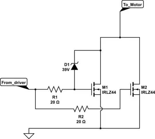

No, you do NOT requires a pulldown resistor for the gates. This is already built into the driver and the driver when powered on will immediately have a defined state.
You MAY require a series resistor since the the driver is rated for only 1.5A maximum. The series resistor is used to limit maximum current and reduce parasitic ringing which may increase dissipation in the output FETs.
As shown in the datasheet:
![enter image description here
As mentioned in another answer you could put a diode across the motor to control back EMF instead of the capacitor, but neither of these are a good solution.
The best way to get rid of the stored energy as fast as possible is to use a Zener across your drive devices. If you do this you will definitively require a series resistor from the driver to the gates since the Zener will hold the drive FETs on to dissipate the back EMF..
Update: One of the comments exposed (@DKNguyen) exposed the potential for gate oscillations between the paralleled FETs, and linked to this paper.
From this it would appear prudent to include a separate series resistor for each FET gate to reduce the Q of any parasitic elements.
Now however you definately will only use one of the FETs (the one with the Zener Drain-Gate) to limit the back EMF, even if the are well matched.

    Shouldn't there be a separate Rg per FET? Otherwise if the Zener avalanches or forward conducts you may exceed the max gate current? – Emily L. Jul 18 '19 at 15:21
    @EmilyL. It does not matter if only one FET conducts for the back EMF …..each one is more than adequate to the task. If either one turns on then it holds the voltage to the required value ….so NO ...you do not need separate resistors for each device. – Jack Creasey Jul 18 '19 at 15:36
  • @EmilyL. You still want individual gate resistors for ringing, however. – DKNguyen Jul 18 '19 at 21:06
  • @DKNguyen I disagree, one resitor is all that is required. What would be the benefit of two resistors? The damping effect is just the same with one since the lead length between devices is likely very very short and any device inductance essentially in parallel, – Jack Creasey Jul 18 '19 at 21:09
  • @JackCreasey Section 3. https://toshiba.semicon-storage.com/info/docget.jsp?did=59458&prodName... There is an oscillation that can occur between the gates of the MOSFETs which bypasses a common gate resistor. – DKNguyen Jul 18 '19 at 21:31
  • @DKNguyen Wow ….Figure 4.8 was a surprise. Notice hover they are discussing very large VDD values to get the oscillation. At <50V it seems unlikely. However I do recognize you are right about the potential for oscillation and will alter the answer appropriately. An extremely good catch. – Jack Creasey Jul 19 '19 at 01:58
