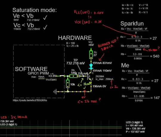

I'm trying to figure out how to create a driver for a led from the GPIO pins of the raspberry and a NPN 2N3904 transistor. I am currently following what seems to be a good sparkfun tutorial. On this tutorial page is a video. So I tried to reproduce what is explained in this video (but English is not my native language) and here is what I understood at my level, it seems that there are several misunderstandings. I simulate the circuit in falstad:

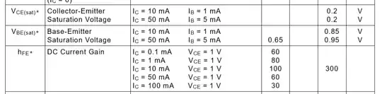

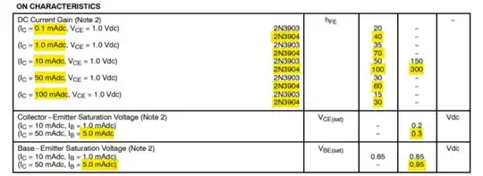

First of all I would like to know if the value of 5mA (the sparkfun sir chosen 0.005A is 5mA) corresponds to the maximum value visible in the data sheet for Vbe (SAT):
(IC=50 mAdc, IB=5.0 mAdc) = 0.95V
, but the sparkfun sir chose 0.6V (which he does not name Vbe(SAT) but 'drop voltage as a diode'? So can we say that IbMAX = Vbe(SAT)MAX = 0.5mA (I also keep in mind that the GPIO port of the RPi seems to give 16mA maximum current). More specifically, does the highest notation for Ib in this form (IC=50 mAdc, IB=5.0 mAdc) in the data sheet actually define Ib MAX? So can we say 'drop voltage as a diode' = datasheet Vbe(SAT) ? which would mean the part of my calculation based on the maximum current of the GPIO port is wrong in this case.
For Vce(Sat) the sparkfun sir uses 0.3V that is 300mV which seems to correspond to the style sheet: (IC = 50 mAdc, IB = 5.0 mAdc) = 0.3V, but falstad displays 110.163mV ?
The LED used is noted 3.0V, 100mA so I deduce 3@0.1A Now if we observe Ic its value is 191mA: 191mA < 100mA? FALSE ! So for me the LED is burning. Knowing that he chose a resistance of 330 Ohms in the end for Ib, that means that there is even a little more intensity which is worse. (unless this person specifies at a given time that it really depends on LED used and that I did not understand).
I want to create a program that can find Rc and Rb automatically and make the most of transistor and LED power. I also wish that this program indicates according to the limits of the LED , transistor, GPIO max current, Vcc used and their characteristics any possible errors.
I saw some people do a calculation for Rb with a factor of 10 to make sure the saturation mode of the transistor (Rb = (Vgpio-Vth) / (10 * (Ic / Beta)) if I remember), here the calculation is a little different for sparkfun (Vgpio-Vth / Ib) where Ib come from ? have a limit ? etc... but the transistor goes into saturation mode too.

  • What the specifications for your LED? A plain LED only needs 10 mA or less, you can drive it directly with the GPIO. – Mattman944 Jul 11 '19 at 18:09
  • @Mattman944, sparkfun sir only say: 3V and 100mA for the LED – Ephemeral Jul 11 '19 at 18:14
    Falstad has a rather unobvious way of modelling LEDs by physics by choosing “ custom diode with a new name you create “ and decide with 3 or 4 parameters that I wont bother to explain. You chose just a (silicon )diode so the result was unexpected. The LED given in the menu is just a simple RED low power one. But you can change several characteristics including colour. Also all transistors are different yet have a peak hFE around 1/3 of max DC rated current, so Falstad assumes you understand this and makes it constant to your choice, so again unexpected result. this sim works great with exp. – Tony Stewart EE75 Jul 13 '19 at 05:53
    @SunnyskyguyEE75, Thank you. Yes I think I understood this over time but I do not know if this is really the right solution, I create a custom name but also a custom model with 3@0.1A as value – Ephemeral Jul 14 '19 at 11:26
    Go to labels , choose LED then edit to desired VI shape . Any LED is possible after you verify VI model . But Beta is always constant. You can graph power too as 6V to 27 Ohm current limiter to 3V , you can expect 1/3W. Experiment with each parameter – Tony Stewart EE75 Jul 14 '19 at 11:58
    @SunnyskyguyEE75. Thank you. What does VI mean please ? Yes If I understand I can change Beta on falstad, but this value will be always constant and and does not take into account the real value of Beta which wants to vary for example simply with the heat (again, If I understand at my level). – Ephemeral Jul 14 '19 at 12:05
    V-vs I transfer function. I think they have sidebar sliders for all parts parameters now which makes Spice look like a square wheel. If avail on right mouse at bottom of part menu – Tony Stewart EE75 Jul 14 '19 at 12:25
    So I can model any Diode 100W or 65mW with Rs (ESR) and the other two parameters – Tony Stewart EE75 Jul 14 '19 at 12:33
    @SunnyskyguyEE75 Thank you very much for all these explanations. – Ephemeral Jul 14 '19 at 12:41
    I have learned more than others than ALL diodes have a Rs (like ESR) that is inversely proportional to the power rating for any single diode. Arrays may be transformed to an equiv Rs. my Stewart’s Law is Rs = 0.5k/Pmax rating +/-50% depending on design and quality tolerances. Simple 5mm LEDS rated for 65mW will be 10 to 15 Ohms , 1Watt LEDs May be 0.5 Ohm at Vf more or less and k is another term =1 for now but later I can explain the slight dependence on Zener Vr and forward Vf Voltage. This has worked on thousands of datasheets to my satisfaction. – Tony Stewart EE75 Jul 14 '19 at 14:58
    Older poor quality LEDs had a wider Vf tolerance like 3.0 to 3.8 V at If all due to this 50% tolerance on Rs. Modern power LEDS are much better tolerance with modern Epiwafer production tools. – Tony Stewart EE75 Jul 14 '19 at 15:02

  1. Assume an hfe less than the minimum in the datasheet. In the data you showed, you could assume an hfe of say 10 which makes calculations very easy.
  2. Divide your target Ic by your assumed hfe to find the base current required.
  3. Look up your expected VCE(sat) from the datasheet at your target Ic.
  4. Look up the Vbe(sat) for your selected device.

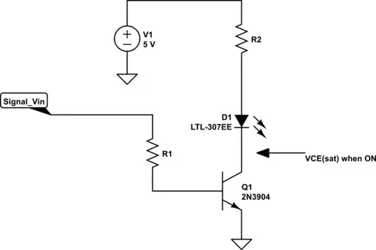

Now lets look at a simplified circuit:
schematic
Now you can calculate the value of R1 and R2 without considering any interaction, since we have assumed an hfe much less than the device provides.
Specification: You must specify the output (Ic), V+ and Vf of the LED required to proceed and here I'll use 20mA to drive a LED with a VF=3.2V from a 5V supply.
You need some details from the 2N3904 datasheet:
R1: ( Signal_Vin - Vbe(sat) ) / (Ic / 10)
For a Raspberry Pi Signal_Vin is about 3.3V (providing the current is not too high).
Vbe for the 2N3904 is about 0.95V worst case at 50mA Ic.
R1 --> ( 3.3 - 0.95 ) / ( 0.02 /10 ) --> 1175 Ohms
You could select either 1.2k Ohm or 1k Ohm and would still be well within the Raspberry Pi I/O current limit since we are drawing only about 2mA base current.
Note: If you had a 2N3904 with a Vbe of 0.65V (the minimum from the data sheet) then the base current would be slightly higher than calculated at 2.2mA for the 1.2k Ohm and 2.65mA for the 1k Ohm values calculated. This is still well within rating.
Note also: we did not consider what might be happening on the Collector side of the 2N3904 at all making the calculation easy.
R2 --> ( V+ - Vf - Vce(sat) ) / Ic
R2 --> ( 5 - 3.2 - 0.2 ) / 0.02 --> 80 Ohms
It would be simple to automate this process in either a spreadsheet or programtically. By choosing a target Ic/Ib you simplify the design process, so you need only consider a small number of details from the transistor datasheet. You will see the Ic/Ib=10 used in many processes when calculating switch characteristics, but you could chose any value you want providing you are ALWAYS assured it will be available in your configuration.
