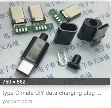

If you are fitting an old style USB 2.0 device with new Type-C connector, here is the answer
However, Type-C to Type-C cables are thick, stiff, expensive, and may fall off from a device that is a subject of frequent moving by user. There is a reason why keyboards and mice have non-detachable cables. To use Type-C host ports, you will be much better off if you replace your Type-A plug on your existing flexible cable with Type-C plug. The plug has to have 5.1k pull-down resistor on one of CC pins. Most DIY Type-C plugs offer pre-fabricated pads for this, like in the pictures below:

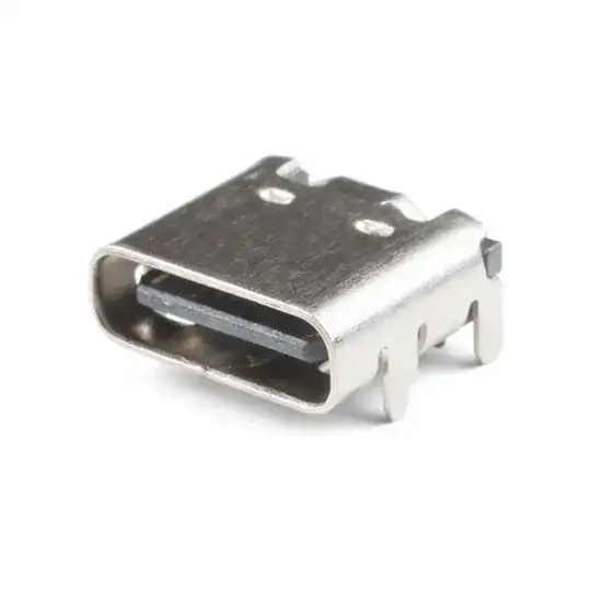

  • Something like this looks like it would be perfect for my use case. How ever I am unsure where I would connect the shield pin from the keyboard. Would I wire it to ground? From the linked item's schematic it looks like it is just left unconnected. – Jtaks Jul 12 '19 at 02:28
  • That sparkfun part is missing a shield terminal. it should connect to the body of the socket, so solder to one of the socket's mounting holes. – Jasen Слава Україні Dec 15 '23 at 03:45
