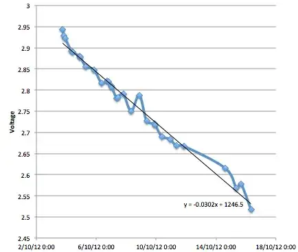

The battery voltage is also affected by temperature. For example, from some of my recent tests the fluctuations correspond roughly to the time of day (temperature) they were measured. If the batteries were hotter, they measured a higher voltage.
Real test

Before I try to do this myself, does anyone know a mathematical function to describe the voltage of an alkaline cell under constant current and/or constant load? An added bonus would be a function that takes temperature as a parameter. Of course a linear approximation often suffices, but I'm after a better fit.
The purpose is to fit the curve (representing the function) to battery voltage readings taken from a device under test. This will enable predictions of battery life, and battery life at different temperatures.

  • Thanks for the comments. @NickAlexeev I've got a lot of field data already actually, using instruments with the same battery pack and same constant current load. I'm after a function to fit to this data battery voltage data, and for other instruments. – geometrikal Oct 16 '12 at 05:36
  • If you have a lot of data already like the graphs shown, you can probably just do a n-degree polynomal fit at a given temperature. If battery voltage vs temperature has a linear relationship (well, im sure there is some degree of non-linearity), it would be pretty trivial to make battery voltage as a function of constant load or current and temperature. – Michael Choi Oct 16 '12 at 07:25
