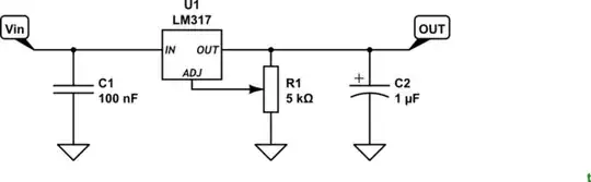

So this is the basic wiring for an LM317 as a voltage regulator, and very little of it makes sense to me. First off, if one pin is for my adjustment, why do I need \$R_1\$? \$R_2\$ will give me just about any value I need to send. Is \$R_1\$ really necessary?
It's always been my understanding that in a voltage divider circuit, you're using INPUT voltage to supply the potentiometer. Why are we using the positive end of the output voltage to supply our pot? Isn't \$R_2\$ wired wrong? If someone tells me to vary voltage to my adjustment pin, I'm going to create a voltage divider with a pot and send THAT output to the pin. But here the V+ input to the pot is the same wire as the wire going to the adjustment pin, AND the same wire coming from my V out of the 317. If I'm trying to send differing amounts of voltage to my IC, how is that supposed to work when I'm ramming a steady V out into the same location?
Lastly, forgive my ignorance of caps but if a capacitor isn't a load, isn't \$C_1\$ creating a short circuit?

    I really like the way you are asking for some help with understanding the concepts related to this device. So +1 for that. A good answer would help not just you, but others as well. – jonk Jul 05 '19 at 18:15
  • R1-R2 form a voltage divider. The output of this voltage divider is fed to Adj. If we remove R1, then R2 just conveys the ground voltage to Adj. – Kaz Jul 06 '19 at 18:22

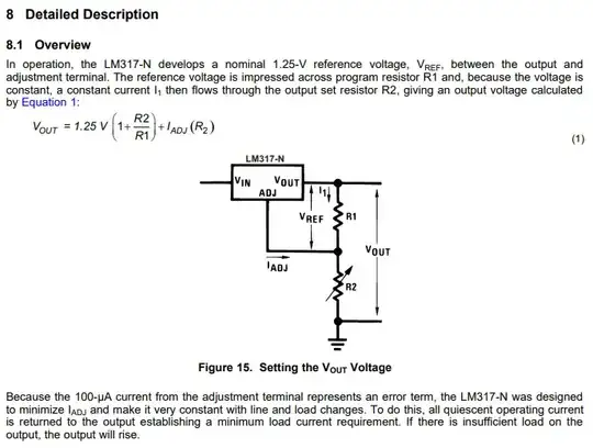

The datasheet has a pretty thorough description of the use of the ADJ pin with \$R_1\$ and \$R_2\$:
LM317 operation
Since both \$R_1\$ and \$R_2\$ appear in the equation for the output voltage
$$V_{\text{out}} = 1.25\text{ V} \times \left(1 + \frac{R_2}{R_1}\right) + I_{\text{ADJ}}R_2$$
you need both in order to realize an arbitrary output voltage. Depending on your expected load and desired output voltage you may be able to remove \$R_1\$. However, you must maintain a minimum load current (which the datasheet specifies as 10mA) so if your load may fall below that you must rely on the \$R_1\$ and \$R_2\$ divider to draw enough current to meet that minimum load current requirement.
With a voltage divider you normally have an input voltage that you want to divide down using a pair of resistors. You set the ratio of resistors in order to set the divided down voltage:
$$V_{\text{div}} = \left(\frac{R_1}{R_1 + R_2}\right)V_{\text{input}}$$
In this case, the divided down voltage \$V_{\text{div}}\$ is set by the device (1.25V) so you are setting the ratio of resistors in order to set the voltage divider's "input" voltage \$V_{\text{input}}\$, which is the LM317's \$V_{\text{out}}\$.
A capacitor has very high (ideally, infinite) impedance at DC so there is no short circuit. This capacitor will short circuit high frequency signals (i.e. noise) on \$V_{\text{in}}\$, which is desirable since \$V_{\text{in}}\$ is supposed to be a DC voltage source.

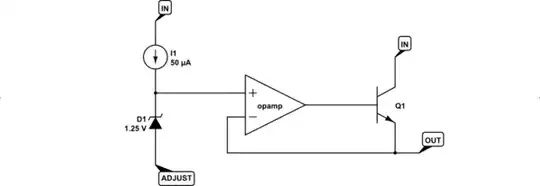

LM317 Internal Voltage Reference
Internally, the device includes a very special type of voltage reference which is set for approximately \$1.25\:\text{V}\$. It's not easy to design one of these, by the way. Especially if you want the voltage reference to stay constant over a wide range of operating temperatures and variations in ICs during manufacture and over a long time period. Here's what the datasheet says about it:
You can see that for a wide range of output currents, input voltages, and temperatures (see the note), this voltage is guaranteed to stay between \$1.2\:\text{V}\$ and \$1.3\:\text{V}\$. That's quite an achievement.
To make this voltage reference work well, the designers also needed some kind of current source. The reason is that in order to make such a good voltage reference they also need to provide a relatively predictable current flowing through it. (Remember, you are providing an input voltage anywhere from \$3\:\text{V}\$ to \$40\:\text{V}\$.) So there is also a current source that provides a predictable current through the voltage reference in order to make this work out well. You can see this fact from this part of the datasheet:
The current source they use sources its current from the IN pin. But that current must leave by way of some other pin -- in this case, namely the ADJUST pin. So this current source's current is called the "ADJUST" terminal current. You are supposed to keep this fact in mind when using the device. You must provide a means for this current source's current to leave the device and go towards the ground reference.
Let's recap. For this voltage regulator to do its job, the designers felt they needed to include an internal (hidden) voltage reference. (They need it so they can use it to compare against and then decide how to "regulate" the voltage you want -- I'll discuss those details, soon.) In order to make a good internal voltage reference, they needed a current source. Because of that, they also needed to let you know that you must help them by sinking that current via the ADJUST pin. So they specify that, as well.
You now have to keep two things in your mind: (1) voltage reference; and, (2) adjust pin current. But the ADJUST pin current is just a consequence of providing that voltage reference. So the main thing to keep in mind, in order to understand the device, is the voltage reference (and not the ADJUST pin current, which is a necessary evil, so to speak.)
That's just one of the internal resources in the device. It also includes some special circuitry to protect against too much current and to protect against serious over-heating in operation. So you get thermal protection, built into the device, too.
Voltage Regulation Method
With the above understood, the basic idea behind the LM317 is the following:
schematic
The opamp is continually observing both its (+) and (-) inputs and it adjusts its output so that these two inputs have the same voltage. By inspection, you can see that the (+) input will be about \$1.25\:\text{V}\$ above the ADJUST pin voltage. So this means that the output voltage will also be about \$1.25\:\text{V}\$ above the ADJUST pin voltage when everything is working right.
This is the most important thing to understand! So let me repeat it. The LM317 uses the internal voltage reference to set the (+) input about \$1.25\:\text{V}\$ above the ADJUST pin voltage and then uses the opamp's behavior to then force OUT to also be about \$1.25\:\text{V}\$ above the ADJUST pin voltage.
The is the crux in understanding how it works. Make sure you run this through your head multiple times. Drill it in.

Lastly, forgive my ignorance of caps but if a capacitor isn't a load, isn't C1 creating a short circuit?
Capacitors, as the symbol suggests, are parallel plates separated by a non-conducting gap. DC current cannot flow through a capacitor once it is charged up.

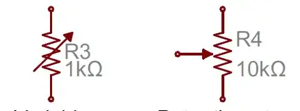

Note R2 is a variable resistor, not a potentiometer (although you can make a potentiometer into a variable resistor by connecting the center pin to one of the extreme pins and using the two connected-together pins with the other extreme pin, or just using the center pin and one of the extreme pins).
You could have the same effect by connecting one potentiometer extreme pin to ground, the other extreme pin to VOUT and the center pin to ADJ.

R1 and R2 are the adjustment. They form a variable voltage divider that generates an input voltage to the Adj pin. If you read the data sheet you will see that the output voltage is regulated to be 1.25V greater than the voltage at the Adj pin.
The output voltage is used to supply the voltage divider because it is stable and regulated, if you used the input supply any noise, ripple or change with load would be passed on to the Adj pin and then appear at the output.
You need to look at the circuit again, the voltage applied to Adj will vary as R2 is varied. It is a conventional way of drawing a variable resistor. Pin Adj, one end of R1 and the wiper of R2 are joined together, not the other end of R2.
Neither C1 nor C2 are short circuits. At DC a good capacitor looks like an open circuit. Their purpose is to bypass any AC component or noise to earth thereby reducing their effect. The data sheet even says you can bypass Adj "to achieve very high ripple-rejection ratios".

Just to add a detail that experienced users might not even notice any more:
R2 a variable resistor - not a potentiometer. In practice, the same physical device can be used, but the variable resistor is a two-terminal device while the potentiometer has three terminals.
Variable Resistor vs. Potentiometer
If you read R2 as a potentiomenter, then it is apparently drawn with the ends of the resistor connected and the wiper not connected (floating), which clearly does not make any sense. One of the terminals of R2 is connected to the wiper.
