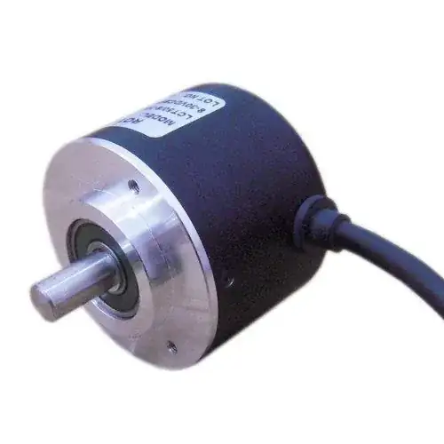

Is there a way to get reading from rotary encoder without microcotroller? just simple circuit that count and increment, like op amp or 555 timer or logic gate . anything that u can help me .

BUT, the encoder DOES NOT COUNT it only provides arc position counts. For example the optical type encoder you show might produce anything from 128 to 1000 pulses per revolution on two channels (A and B).
Assuming you want an up/down counter that tracks the angular change pulses in the encoder (and you show an optical encoder), all you need are TTL or CMOS counters.
You need logic to perform:
- Pulse production derived from the leading edge of the sensor output channels. The encoder signals are a quadrature output where the phase relationship tells you the direction.

Your time would be much better spent using a small MCU such as the ATTiny85 or an Arduino Nano (ATMega328) to do the encoder interface and the up down counting. You can get either of these for under $3 online.
