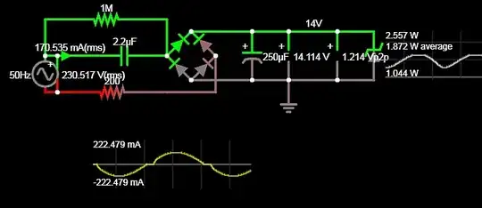

  • With 12Vdc drawn from 230Vac, you have a current-limit by 100Ω and 2.2uF @ 100Hz = -j800 Ohms for an apparent current of ~170 mA .
  • with 230mA rms thru 100 Ohms the power dissipation is I^2R-Pd=5.3W exceeding its rating and operating a finger burning max temps of 150'C+
Conclusion
You must use an e-Cap rated for > .4A ripple current with low ESR for safety or reasonable life.
  • Don't use Chinese Caps with no specs ( Japanese are far better)
    • example Rubycon Manufacturer Part Number 25ZLH470MEFC10X12.5 730 mA ripple @ 120Hz
Proof with SIM enter image description here - Always derate power resistors at least 33% and pre 50% - so use a 10W resistor or add another 100 OHm 5W in series. which only reduces overall current by 5mA.

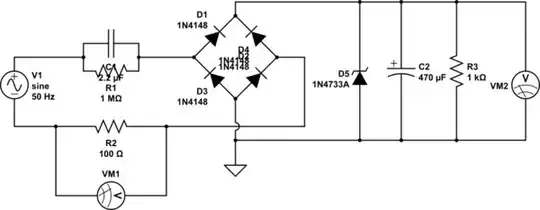

schematic
Simulating that shows you get a 15V peak drop across the 100 Ohm resistor. 15V*15V/100Ohms = 2.25W. Whether the resistor can survive that and is rated for it, it's still burning a lot of energy and it's going to get hot.
Also, what everyone else said. Be safe.
