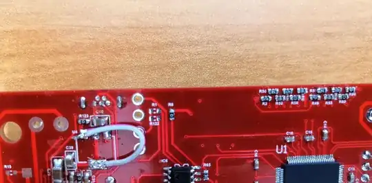

In a PCB I've been developing, I included a micro USB connector. The problem is that when I plug in and out cables on it, seems to get weaker and weaker and needs to be resoldered, even the pins on the center seem to give some problems.
Is there something I can do on this board that can improve it or another type of connector? Anyone had problems with it?

    Unless your case can provide some mechanical support, the vertical mount really isn't going to work. You may need to swap to a different mounting style. – hekete Jun 28 '19 at 06:54

Micro USB has its flaws.
Phone manufacturers often use mid-mount USB sockets for best mechanical strength.
Any vertical version will have the drawback of the length of the plug acting as lever on the joints. You will definitely need additional mechanical support by the enclosure on these.

Why don't you take a plug that lies flat on the PCB? That's how I've seen it on every PCB so far.

In addition to Daniel K's suggestion for a horizontal-mount connector, you should also consider the mechanical benefits of through hole (THT) components. I've had issues with SMT-only horizontal USB connectors pulling up from the board and ripping the traces themselves.
A good compromise can be a combination of SMT pins for the USB connections with THT mounting points for the connector body, which I've found provides a lot of help with mechanical strength. enter image description here
Source
Generally, surface mount solder joints alone shouldn't be relied on for mechanical support of connectors* with significant mating cycles or non-trivial mass. This is especially true for vertical style connectors as shown in your image, where you can easily get a lot of leverage on the connector body and snap the part off the board.
*Small embedded connectors that are not user accessible are a different story.
