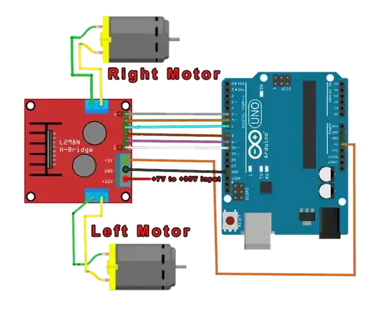

I've already repair a cleaning MOP but with this one I have a problem with the brushless motor which is throwing some party fun in the circuit. First I was Using the onbord 5v regulator from the l298n module like this: enter image description here But when the brushless FAN motor start turning quickly, the Atmega start to hang. I've tred to use a powerbank to power the IC and it was going well.

  • ok indeed my mistake I wanted to say "5v regulator from the l298n module". each motors have 1.5A stall current, so I found that the l298n would do the job. I've add a picture in my post – bodtx Jun 21 '19 at 14:14
    Like most people who come to that mistaken conclusion, you are neglecting the absurd losses in the L298. Again, this has been covered here many times before, read the related questions. – Chris Stratton Jun 21 '19 at 14:15

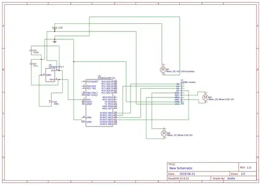

    You show Brushed DC motors in your diagrams …..where are the Brushless motors you reference in the question? The L298 is just fine at 15V, BUT it does not have enough capability for your 3.5A motors. You appear to be driving the L298 incorrectly. In your schematic one motor is directly across 15V!!! the other is driven across A and B outputs ...why?? – Jack Creasey Jun 21 '19 at 15:02
  • @ChrisStratton L298 is 2A max per channel so 1.5A stall current should be ok I think even with great loss. Jack look at my link it is a vacuum robot so when I switch on the brushless motor is directly plugged on the battery, the other part is just for the wheels motor. On my schematics there is not the second wheel motors indeed. – bodtx Jun 21 '19 at 16:50
  • Sorry, but you really are not understanding the issues with the L298. It's not the peak rating, it's the amount of your battery charge it will uselessly turn into heat. Additionally it would appear that the fan is drawing more at startup than your battery can support, a sound design would ramp up the speed to moderate that. – Chris Stratton Jun 21 '19 at 23:29
    In your schematic the LM78L's ground is not connected to circuit ground. Please correct this mistake. Motors draw high current at startup, which can upset sensitive parts of the circuit if the ground wires are not run separately. Please show us a photo of your setup with all wiring clearly visible. – Bruce Abbott Jun 22 '19 at 00:47
  • @ChrisStratton ok I've note that at high amp the loss is great with l298, I've choosen from here https://www.pololu.com/search/compare/11. Maybe I can test to start wheels motors only after the rampup of the brushless motor (5-6 seconds). Bruce, I have corrected the schematics, thx. I hope the added video will help, my mount is messy so a single photo could not help I think. – bodtx Jun 22 '19 at 12:07

I hope the large skinny loops on your schematic will teach you these are loop antenna and your fun isn’t over until you stop broadcasting noise with BW up to 0.35/Rise time of current or voltage spikes.

    Finally what seems to work for now is to wait that the brushless fan's speed is stabilized before driving the motors wheels. Once the fan is at full speed I can start. I have also to drive the brush (to clean not brushed) motor, I will also rampup this motor slowly and wait before starting the wheels. I've twisted all the cables as the original design was done like this, it helps to get ride of EMI. Thx! – bodtx Jun 26 '19 at 07:50
