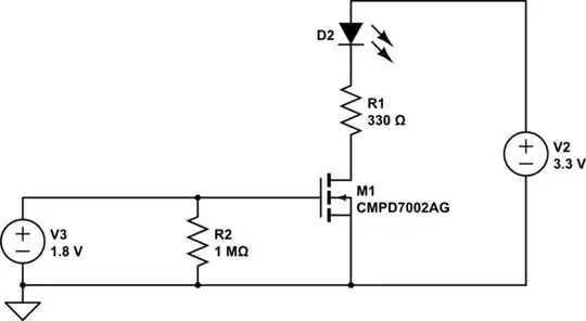

I am driving a red LED with a forward voltage of approx. 2 V as shown in the picture. The driving signal comes from a microcontroller with a logic HIGH of 1.8 V. The LED is being sourced from an independent supply of 3.3 V. The circuit works, but there is something in my measurements that I can't explain.
I measured 3 mA through the LED branch. I need more current through the LED (about 10 mA would be ideal). Then I reduced R1 in steps until I had about 10 Ω, yet the current in the LED did not change much. Sometimes I measured about 8 mA at the beginning of the measurement which after some seconds ended up at 4 mA.
  • Why is this happening? I also reduced R2 but it seems to have no effect either.
  • How could I increase the LED using a control signal of 1.8 V and powering the LED with 3.3 V?

  • got a link to the data sheet of your mosfet? – Marcus Müller Jun 14 '19 at 15:22
    It seems to have something to do with maybe some current limit on the mosfet, or its internal resistance. I wasn't able to find its datasheet by the model specified on the circuit... Can you provide one? – Iaka Noe Jun 14 '19 at 15:22
    I'm pretty sure the answer is in the datasheet for the MOSFET. Provide a link to it, please. – Elliot Alderson Jun 14 '19 at 15:24
    If you want a direction what voltage you need to decently drive a mosfet: do not be guided by Gate Threshold Voltage $V_{GS(th)}$, but check the Test Conditions given by the Static Drain–Source On–Resistance $R_{DS(ON)}$. – Huisman Jun 14 '19 at 15:51

  • Thank you for your comments. Here is the datasheet of the component. Not sure why it didn't come up in the search results. https://eu.mouser.com/datasheet/2/68/cmpdm7002a-25208.pdf In it is stated that Vgs minimum is 1 V and that is the parameter I took in consideration. But maybe I didn't pay attention to other important characteristics. Your input is always appreciated. – Daniel Jun 17 '19 at 08:37
The problem is most likely that the mosfet does not have enough voltage to fully turn on. Vgs is probably not high enough. I couldn't find the datasheet for the CMPD7002 (or any part named that). First make sure the Vgs will give you enough current, find how much Vgs you need for the Rds on. You'll need to do one or more of these things:
1) If the GPIO's on the microcontroller are 3.3V tolerant (or if 3.3V is fine with a pull down) Then use open drain on the GPIO and a pull up to 3.3V
2) Use a circuit or buffer to translate 1.8 to 3.3V
3) Select a different mosfet that turns on at 1.8V and has a low rdson at 1.8V.
4) Calculate the current vs LED drop and size R1 correctly.

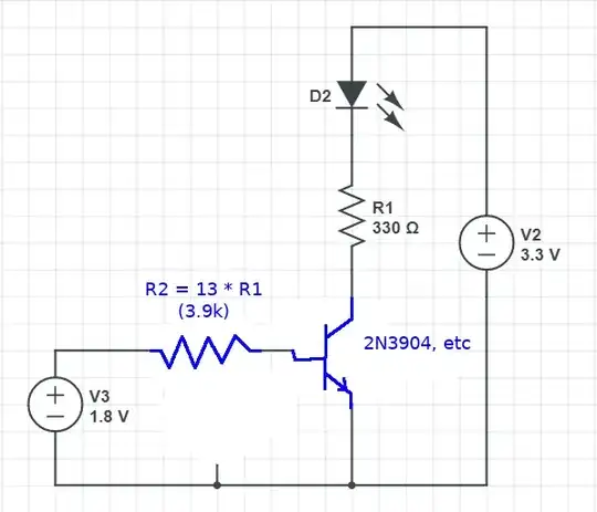

Use a good ol' BJT, or find a logic-level FET rated for 1.8V. I've called out a 2N3904 in the suggested schematic below, but (A) you can use just about any small-signal NPN there, and (B) there are prebiased transistors that'll work and save you a resistor.
Design for an 0.7V drop from base to emitter, and a base current of about 1/10 of your desired collector current, to keep the transistor hard into saturation.

  • This should be good for 3mA if R2 =13R1 1.8/3.3 – Tony Stewart EE75 Jun 14 '19 at 18:41
  • I'm not sure what you're trying to say. The collector current is (3.3V - 2V)/R1; the base current is (1.8V - 0.7V)/R2. The base current needs to be 1/10 the collector current, and I rounded the V3-base voltage to 1V -- so R2 = 10 * (1.3V)/(1V) * ) * R1 = 13*R1 more than satisfies the rule of thumb for base current in a saturated transistor. If the OP wants more current, then they need to reduce R1, and then R2 to match (while observing the current source capability of the pin they're driving the gate with). – TimWescott Jun 14 '19 at 19:22
  • Ic=(3.3-Vf-Vce)/330=3.6mA if Vce=0.1 when Ib= 364uA with (1.8-0.7)/364uA= 3k so R2/R1= 6.06 – Tony Stewart EE75 Jun 14 '19 at 19:31
You need a MOSFET that turns on fully with 1.8V. Not many will. Do you have a datasheet for CMPD7002AG? I'm not getting any hits on it.
This one looks like it will turn fully with just 0.9V on the gate
https://www.onsemi.com/pub/Collateral/MCH3484-D.PDF
Digikey has them.

  • Hi, this is the datasheet: https://eu.mouser.com/datasheet/2/68/cmpdm7002a-25208.pdf It is strange that it is not being shown on the search results. According to it the VGS (Threshold) can be as low as 1 V. This is the parameter I used to pick this MOSFET but maybe I misinterpreted other parameters. Is it incorrect to assume that once Vgs is bigger than its threshold value the MOSFET is fully ON? Thanks – Daniel Jun 17 '19 at 08:23
  • The range of the threshold voltage is from 1V for some of them to 2.5V for others of them. The DS Mosfet current at its threshold voltage is only 250 micro-amps which is almost turned off. Buy hundreds of them and test them all then maybe you will find one that is more sensitive than the one you have. – Audioguru Sep 08 '22 at 01:18
