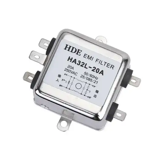

Your UPS and PC PSU may have a discrete version of this line filter (aka Pi filter) enter image description here
You can look up the ground leakage specs for your UPS and PC. They may be 0.25mA max each, I believe. Check EN 60950-1 class ratings.
This is why the frame ground and Neutral will have leakage currents that will begin to flow if you become the earth ground path with stray leakage thru the moist air to earth ground.
Therefore if using it in this mode in future beware of this potential nuisance.
