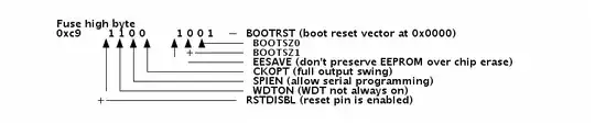

You can play with something with graphviz and dot. Those are the tools doxygen uses to create the diagrams. It is not exactly what you are searching for, but it is fast and easy to script and the output is kind of nice looking (even thou it is a little hard to follow some lines...)
This example will generate something like this
alt text
To do this you first create a file called byte.dot

Then run one of those commands.
dot -Tps  byte.dot -o byte.ps
Maybe it will be nicer if we do not cross all the lines in the middle?
alt text
I just switched the named in the second table from f0..f7 into f7..f0.
