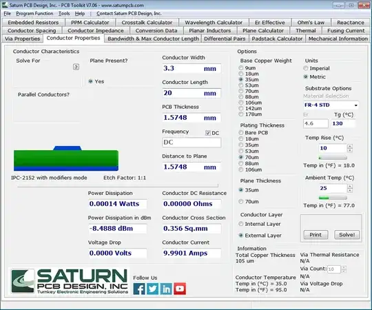

If you do not have temperature sensitive components nearby, conductor temp may be allowed to reach 60'C safely.
But if you do want 10'C rise max, then use thermal pads, 3.3mm tracks on 3.5mm spacing 0.2mm gap (8mil) with 1oz base +2 oz plating on outer, with a ground plane to reduce temp rise 50%.
enter image description here Or spread out the traces as Phil has done.
Beware that the heat rise is cumulative from adjacent tracks. The above would not be true if every track used 10A.
