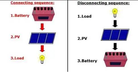

Gone through the datasheets what you have provided. There is nothing wrong in the configuartion.
The MPPT controller supports up to 75V / 100V PV open circuit voltage.
Panel power is also with in the maximum range of MPPT.
The MPPT also has an auto battery select option for 12V/24V batteries.
You can hook-up all these together with out any doubt.
Follow this article for detailed explanation and procedure
