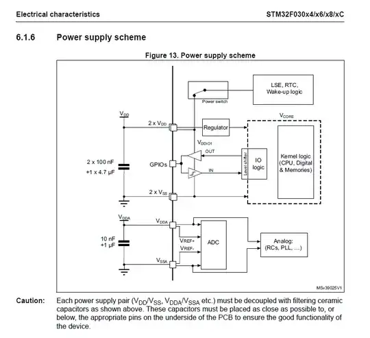

I'm trying to understand what ST recommends for decoupling caps for STM32F030CC.
The diagram in the datasheet shows "2x100 nF" caps on the Vdd/Vss pairs. Does this mean 2 parallel 100nF caps per Vdd/Vss pair? Or are they referring to the total number of 100nF caps needed, i.e. if there are 2 Vdd/Vss pairs then it's 1 100nF cap per Vdd/Vss pair, for a total of 2 100nF caps?
STM32F030 datasheet
power supply schematic from the STM32F030 datasheet

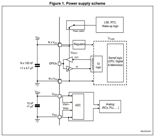

They are referring to the total number of capacitors needed.
ST has a useful document: "AN4325 - Getting started with STM32F030xx and STM32F070xx series hardware development"
Inside, it is a bit more clear:
And they explain it directly in Section 5.4:
