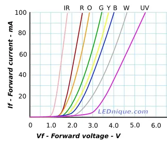

Figure 1. The I versus V curves for a range of typical LEDs shows that the forward voltage of an IR LED is about 1.25 V at 20 mA. Source: LED IV curves.*
Note that if you were to apply even 2 V to the IR LED that the current would exceed 100 mA and it might not last long. At 5 V a bare IR LED would almost certain die instantaneously.

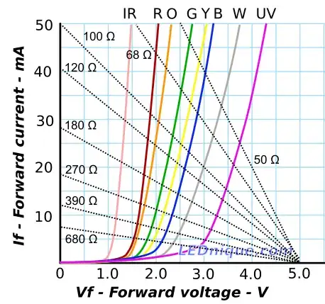

There are many, many sites on the Internet that explain this. The load-line tool below may be of interest.
Figure 2. A loadline graphic calculator for various LEDs on a 5 V supply. Source: Loadline resistance graphic tool.
To use the tool:
  • Select your LED colour: IR in your case.
  • Select the current you want: 15 mA in your case.
  • On the If axis move up to the 15 mA line and move across to the IR curve.
  • Select the nearest loadline curve: 270 Ω.
A 270 Ω resistor will limit the current through your IR LED to about 15 mA on a 5 V supply. There will be 1.25 V across your LED and about 3.75 V across your 270 Ω resistor.
