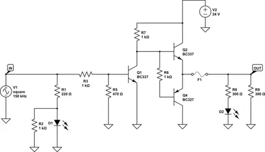

I've thought about an opto like the TLP293, but too much current. I've done a test with 2 NPN and 1 PNP but it didn't work as expected.
Do you have any suggestions to analyze?
It's a test circuit. Main use will be to light the LED of an opto-isolator at 20 mA, but I'll use it also for different test purposes. That's why I didn't specify more.
Here's what've used:

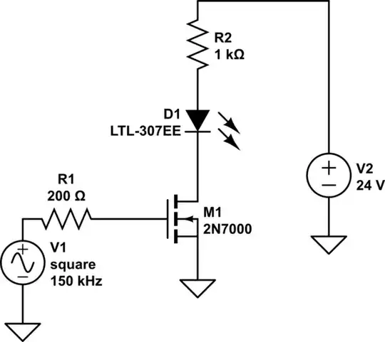

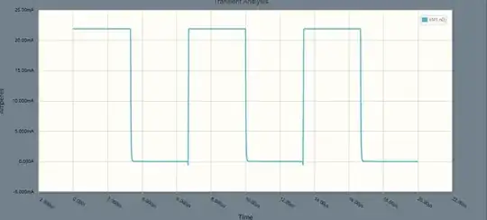

Drive a small MOSFET such as 2N7000 or 2N7002 with your 5V signal. In the below schematic, the 200\$\Omega\$ resistor represents the source impedance of your 5V signal- it doesn't have to be an actual resistor.
schematic
The MOSFET (assuming it's a small one like I suggest) is easier to drive and suffers less from storage effects than a BJT. If you really want to use a BJT you can connect a BAT54 Schottky diode from collector to base to act as a Baker Clamp to avoid saturation, or drive the transistor with a resistor in the emitter as a constant(-ish) current sink.

  • I'd to use the low side of the transistor. This because will allow me to place a pull down resistor. – Singed May 29 '19 at 09:38

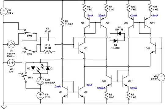

The approach below harkens to the early 70s, and the heyday of ECL. The LEDs need to be connected symmetrically. One of them can be replaced with a "dark" diode.
The current is sourced by the reference current source Q1/Q2, and subsequently switched into one of the two current multipliers: either Q8/Q9 or Q10/11. No LED series resistors are necessary. Switching is quite fast, and in practice risetimes <100ns are possible.
This driver has inherent current limiting, even when faced with shorts on the output. Current limiting is about as fast as switching: dead shorts will drop down to 20mA current limit within a few dozen ns.
For ground-referenced single LED, anti-saturation bypass transistors are necessary. Those are TBD.
schematic
Q8/Q9 and Q10/Q11 need to be same types in each pair, thermally bonded, and able to dissipate about 5W. This is a conservative rating, and includes ample derating for the Safe Operating Area (SOA) typical of devices of this size.

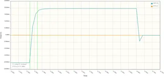

The switching waveform looks half-decent. Included is a short-circuit event.
The switching waveform of the ECL-like current steering switch
The detail of switching and short-circuit protection is below:
A zoomed-in plot of the normal switching event followed by a short-circuit
