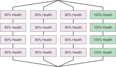

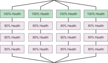

In my off-grid solar system I am using quite good lead-carbon batteries capable of surviving 4000 cycles when discharged up to 50%. Their Partial State of Charge (PSOC) wear is minimal. Also they can be charged 2.5 times as fast as traditional lead acid types. At the moment I am running 12 of them — connected in 3 parallel quartet series. I am giving them quite hard times — discharging down to 50% every night and topping up to 100% during daylight.
Now I want to scale the array up — add another quartet or two. Say if I do it this way it perhaps would be quite bad:
But a gut feeling tells me I might get away with this:
I am sort of lazy to do the calculations vs ask this question. Is my gut feeling wrong or right? Is there any difference between the two options above? How much will the new batteries suffer if the old ones are only say 20% worn? Should I even think of scaling the array up, or should I just wear it out completely and buy all new batteries thereafter?

If the chemistry provides a stable voltage-SoC relationship, then this mixing can work without extra electronics. In that case, your gut is wrong and the all-in-one-stack option is best. That's because you have two scenarios to consider: charge and discharge.
During charge, the weaker batteries will reach higher states of charge quicker. Provided the voltage-SoC relationship is stable, that means they will automatically accept a smaller proportion of the charge current as the stronger batteries remain at a lower internal voltage for longer. If this were not to happen the weaker batteries would overcharge.
During discharge the opposite happens. The weaker batteries will reach lower state of charge quicker but the arrangement will automatically compensate by the stronger batteries taking a greater share of the load.
If instead you were to go with your gut, you'd find the weaker batteries in the string are both overcharged and undercharged as they are forced to take the current that the stronger batteries are capable of.
When it comes to scenarios where you don't/can't know which batteries are the weaker ones, then you have to turn to individual compensation electronics. There are various systems for bypassing individual batteries in a string to compensate for their more rapid changes in State of Charge. Again, they generally rely on the Voltage-SoC relationship being stable. If it is not (eg. Lithium based chemistries), then generally a coulomb-counting approach has to be used.

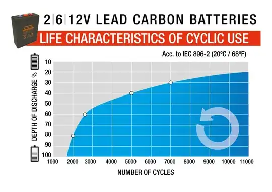

  • Most of this answer is just completely wrong. If you tie the batteries together then the terminal voltage of the series/parallel array is ABSOLUTELY the same. The only difference is that older battery's have a lower CAPACITY. The older (lower capacity) batteries will NOT overcharge or undercharge compared to the newer (higher capacity) batteries. The side effect of putting older (lower capacity) batteries in parallel with newer batteries is shown clearly in the graph Laptop2d showed. Since the terminal voltage is related to SoC you want to reduce your discharge terminus in a mixed pack. – Jack Creasey Jun 07 '19 at 18:33
  • Thanks @JackCreasey, I added the word "internal" to try to clarify. I didn't want to get too complex but as you suggest it is confusing to imply that the batteries will be at different voltages. You might want to have another look at the graph - it shows battery life (number of cycles) vs how deep each cycle is (DoD), which is not related to the matter at hand. On the other hand, over/undercharging of weaker batteries in a series string is a well known phenomena, as is the self balancing effect of dissimilar batteries in parallel. https://www.mpoweruk.com/balancing.htm – Heath Raftery Jun 08 '19 at 00:28
  • Cell balancing is important, but in this question it simply means you'd never mix old and new cells/batteries in a series string. This is where a BMS becomes essential of course. If batteries are kept in their series configuration with the same aging and new series connected string are added in parallel, then the problem is as I commented. You have to use the new cells at a lesser depth of discharge so you don't stress the older strings. So depth of discharge is central to answering the question posed. – Jack Creasey Jun 08 '19 at 01:26
It's wrong, the problem is if the cells do not match, more current (usually) gets dissipated in the unmatched cells.
The problem is in the Depth of Discharge, it goes down over time. In either configuration the batteries that still need to be charged will show a lower voltage then the ones that don't if the batteries are not matched. This will at minimum waste energy as heat, at worst it will lead to failures in the battery.
I think the best thing to do would to keep the old batteries on their own string with their own charger and leave them matched to each other.

    All I know is when we installed batteries on satellites we had to match them, and if you don't match batteries its bad and it degrades them and wastes energy. There is plenty of stuff you can get away with, depends on what your risk tolerance is. I would say no to either configuration, but if I had to pick one I'd pick the parallel one – Voltage Spike Jun 02 '19 at 04:53
