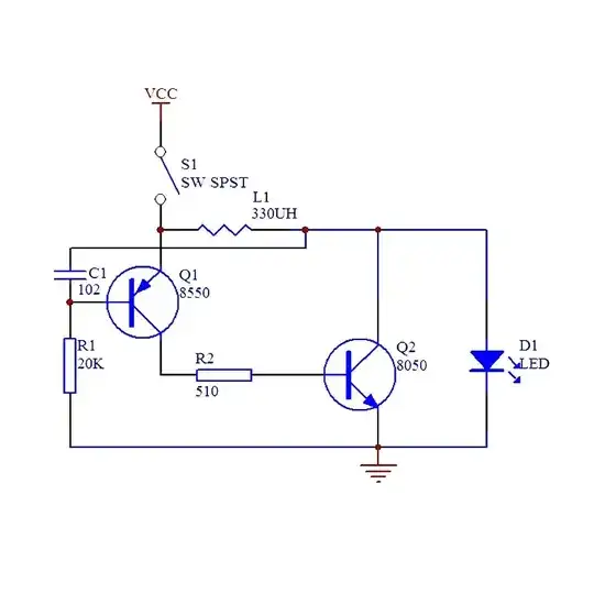

I bought and soldered a dirt-cheap flashlight kit from China. I'd like to understand how it works, though - specifically, why it uses a combination of a PNP and an NPN transistor (schematic from the product page is below).
If the circuit does end up in a steady (read: frozen) state, then the inductor acts as just a wire - so the LED ends up just being directly connected to the 5V (which wouldn't bode well for its longevity). EDIT Was wrong here - this was battery-driven, so 1.5V, not 5V!.
Therefore this circuit clearly is not meant to arrive at such a steady state - it is designed (presumably) to oscillate. Unsure why one would want that - but even if that is the case, couldn't that be achieved by just a single transistor - whose base would be driven by the cap, placed between base and ground? i.e. voltage rising on a charging cap reaches 0.6V, transistor opens, flashes the LED, cap charges again...
I am clearly missing something here - why the two transistors?
P.S. Amateur at electronics, go easy on me :-) P.P.S. I could add a link to the product, but I don't want this post to be misclassified as spam.

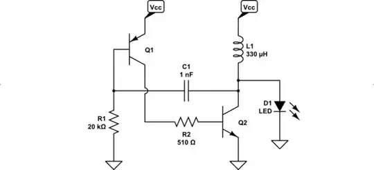

Schematic

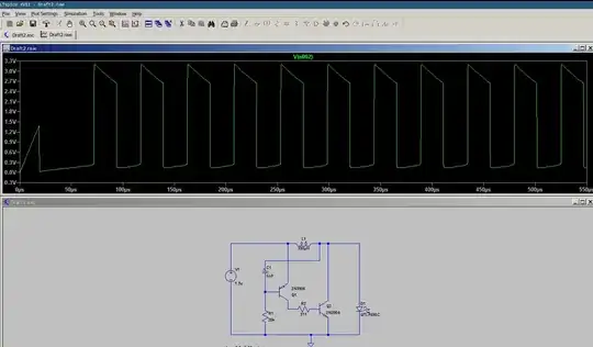

UPDATE: Simulated it in LTSpice:
Boosting voltage up
... and see now that it boosts the voltage! Which makes perfect sense, now that I realize the LED needs more than 1.5V (the AAA battery I added in).

My theory so far: the 20K pulls down the base of the PNP to ground, so initially the PNP is on (V_BE negative, more negative than 0.6V) - which means that NPN is also on (V_BE also much higher than 0.6V). Both transistors are therefore strongly ON - and current therefore flows through the inductor via Q2 to ground. But no current goes on the LED - since that has a higher voltage threshold - it needs more than the battery's 1.5V.
This is where I start to lose the thread.... I believe that current also flows through the inductor to charge the cap via R1... I am guessing that at some point the Q1 goes off (and therefore, so does the Q2). But I am unsure how the cap does this "cutoff" - as it is charging, the V_BE voltage keeps increasing, so I am unsure how the Q1 ever gets to cut off...

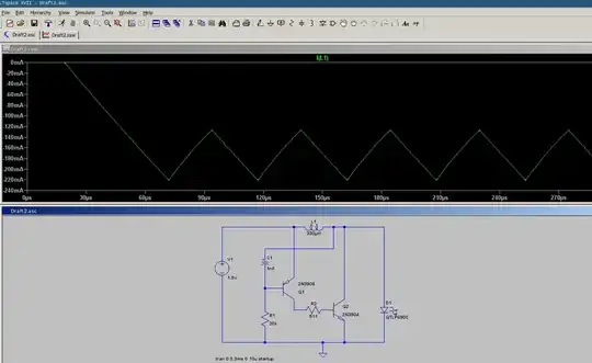

Looking at other stuff in LTSpice I am more dumbfounded - e.g. it shows that the current of the inductor is always negative:
Negative current through inductor?!?

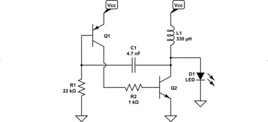

Just to get the schematic into the editor supported here and to draw it in a slightly better form for analysis:
schematic
I've dumped the switch (implied.) I've stopped busing power around and just used a ground and \$V_\text{CC}\$ indicator, instead. This helps to focus a little better on the schematic without distracting wires which don't contribute much to understanding. But except for the switch, it is the exact same schematic as you provided.

So the resulting circuit is:
schematic
simulate this circuit

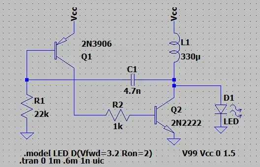

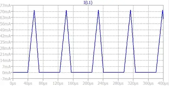

The above schematic in LTspice is:
The resulting inductor current waveform is:
The resulting frequency is about \$11.7\:\text{kHz}\$. Not too far from where I targeted using simplified equations and rounding to standard valued components. And the current peaks are close enough, too.

Note: You mentioned reading a negative current and I need to point out that you should be aware that LTspice treats each two-terminal device as having two nodes: an entry node called "1" and an exit node called "2". These "netlist" numbers are internal and you don't normally see them. But LTspice does see them. When you hover over the device, there will be a little arrow telling you which way LTspice "sees" the current flowing. If the conventional current does flow in that direction, it reports it as positive. If not, it reports it as negative. If you don't like what it is reporting, you can grab the part and reverse its direction using the "ctrl-E" keystroke and then put the part back down into the schematic, again. It's no more serious than that.
