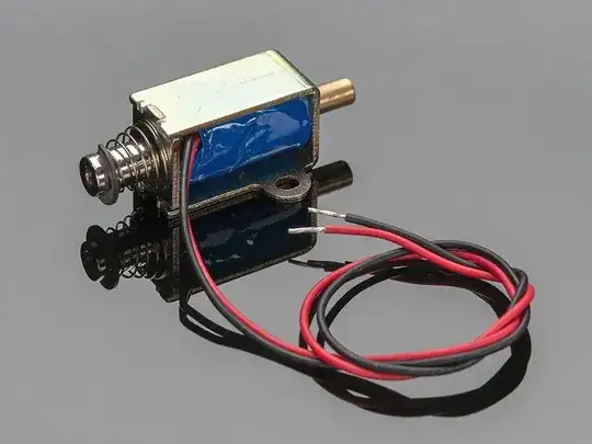

If I understand correctly, a regular solenoid like this one
does not have a permanent magnet as core and as such it doesn't matter with what polarity it is activated (please correct me if that's wrong).
Since the current in the winding takes some time to decay, it's apparently possible to release the solenoid faster by applying reverse voltage (to "flush out" the current)
but since the polarity doesn't matter to activate the solenoid, I assume that there is a specific duration for which this reversed polarity should be applied or otherwise the magnetic field just builds up again in the other direction and pulls the solenoid back in.
How can I compute the duration for which the reversed polarity should be applied (based on rated voltage and current of the solenoid as well as number of windings) in order to achieve fastest release?

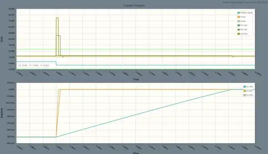

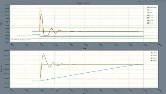

Update: I added a fourth method due to comments from @Sunnyskyguy that the snubber would be effective. This is NOT correct, since a snubber forms a tuned circuit, so the current reverses and will still hold the solenoid in for much longer than the Zener based solutions. A snubber works well for a physical switch but as you can see in the above circuit I had to add a Diode to catch the swing below zero which will destroy transistors and their driving circuits. An FET has an internal body Diode, so a snubber can work for those ….but it will NEVER be more effective than the Zener methods.
The waveforms for the 3 methods show the time for the current to fall to zero for the inductor I chose:
Method A took 1.3ms while method B and C reduced to less than 40us.
Here is the second waveform view showing the comparison with a snubber circuit (Method D):

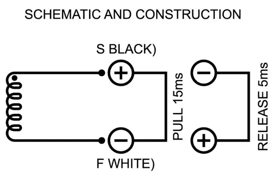

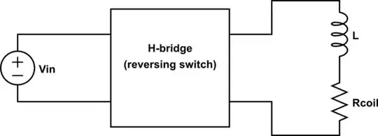

Several other answers have addressed ways to automatically and passively dissipate the energy in a highly effective fashion. I'm going to answer the exact question you asked: how long should reverse voltage be applied, if applying reverse voltage is how we're going to do it?
Let's consider the solenoid as an inductor, without the effects of the moving core. Then the goal is to drive the current through the solenoid to zero.
schematic
The magnitude of the current assuming that the solenoid has been on for a while is \$I_{\text{on}} = V_{\text{in}}/R\$, because it is determined by the coil resistance and not at all the inductance.
Now suppose we reverse the polarity. This is readily done with a H-bridge as would be done for reversing a motor — a solenoid is electrically the same kind of thing. Then we have applied a step voltage change (of \$2V\text{in}\$) to the solenoid. How do we know how it will respond to this? It's an RL circuit! The step response of such a circuit, in the usual form of “applied voltage was zero at \$t=0\$ and is now a constant \$V\$”, is
$$I(t) = \frac{V}{R}(1 - e^{-(R/L)t})$$
In this case we're considering not going from \$0\$ to some \$V\$ but from \$+V_{\text{in}}\$ to \$-V_{\text{in}}\$, but since this is a linear system it doesn't matter where we start; to use this equation we just need to double the applied voltage. Then the condition we are looking for is when this curve is equal in magnitude to the steady-state on current \$I_{\text{on}}\$, which is the same time as when the actual decreasing current will equal zero. (We could do this with less fiddling by starting from the differential equation \$I = dv/dt\$ and solving it, but I figure reusing existing well-known solutions is a more practical-intuition approach.)
$$ \begin{align*} \frac{2V_{\text{in}}}{R}\left(1 - e^{-(R/L)t}\right) &= I_{\text{on}} \\ \frac{2V_{\text{in}}}{R}\left(1 - e^{-(R/L)t}\right) &= \frac{V_{\text{in}}}{R} \\ 2\left(1 - e^{-(R/L)t}\right) &= 1 \\ 2 - 2e^{-(R/L)t} &= 1 \\ e^{-(R/L)t} &= 1/2 \\ -(R/L)t &= \ln 1/2 \\ (R/L)t &= \ln 2 \\ t &= (\ln 2)\left(\frac{L}{R}\right) \\ \end{align*} $$
That is, you should apply reverse voltage for \$(\ln 2)\left(\frac{L}{R}\right)\$, or about \$0.7\$ times \$L/R\$, seconds.
\$L\$ and \$R\$ can be found from the specifications of the solenoid or, if documentation is not available, using an LCR meter or other methods of measuring inductance and resistance.
However, this theoretical answer makes several assumptions:
  • The moving, temporarily-magnetized iron has no effect.
  • Your power supply is an ideal voltage source which doesn't blink at this inductive load. (I'd think of having a big decoupling capacitor, sized to store a few times more energy than we're putting into/out of the coil, right next to the input of this drive circuit. That way, the current and voltage surge flows mostly through the capacitor rather than the rest of the supply circuit.)
  • The H-bridge or other reversing device is also ideal.
In practice, if you wanted to do it accurately, you would want to apply the reverse voltage until you detect that the current through the coil has hit zero, then open the circuit.
And, in practice, the various passive energy-dissipation circuits posted in other answers are common and better solutions. Instead of dumping the energy into power supply rails, it is dissipated through a large semiconductor voltage drop. Since this can be a higher voltage than the power supply normally uses (on the principle that an inductor will produce as much voltage at its terminals as needed to cause the current to flow), the decay of the current is even faster than using reversed supply voltage.

    I considered this but rejected it as the reverse voltage would need to be -24V or much greater than +12V to be as fast as a 33V Zener – Tony Stewart EE75 May 15 '19 at 17:36
  • @SunnyskyguyEE75 I was going to ask, where are you getting the 33V from — but then I remembered that the inductor will generate the voltage as needed, of course. I'll update my answer. (But, as noted at the top, this is primarily about answering the question that was asked, not alternative solutions.) – Kevin Reid May 15 '19 at 17:39
  • This answer is very complicated. The H-bridge can work, but when you initially toggle the drive voltage you MUST not have both upper and lower pairs on at the same time (dead time). This means extensive logic to ensure that the drive is correct to prevent shoot-through. During this dead time you need diodes to protect the H-bridge or else the BackEMF will kill the switch devices. While this certainly can work, it's certainly not usual to see a non-polarized (soft iron core) solenoid driven like this. You also have to measure the current direction and magnitude to get any accuracy. – Jack Creasey May 15 '19 at 22:54

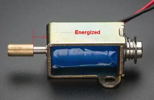

How does this solenoid work?
enter image description here A soft iron rod end leaves an air gap in the coil end in the retracted position. WHen any polarity current is applied this offset iron rod is pulled to fill the air gap inside and balance the flux at each end.
The soft iron is always pulled to the centre regardless of which side of the coil it is positioned. The applied current and inductance both increase the pulling force of offset ends towards the centre of the magnetic coils. A thin magnet wire (eg. AWG30) with 1000+ turns adds 40 Ohms resistance which limits the current. Non-magnetic extension rods are used to make it mechanically push or pull to suit the application. In this case it pushes to the left.
Thus the only force available to make it retract is the spring and the faster current is cut off, the faster the magnetic force can be removed and the sooner the spring can act.
There is no electromagnetic solution to reverse the force. ( unless you had a dual solenoid in opposing directions or change the part to one with a stronger spring.)

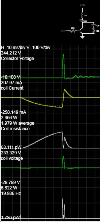

  4. Resistor or RC snubber across coil or switch Faster or equal to Zener utilizing low L/R time due to high R value but needs non-polarized cap or protected cap
The electrical factors that make the fastest possible return speed are :
  • high reverse voltage from BEMF i.e. higher switch voltage rating
  • higher resistance the faster the stored Joules are dissipated with higher pulse power.
    • dI/dt = V(t)/L = I(t)*R/L
      • or dt= L/R * dI/I(t) thus reducing numerator or increasing denominator makes it faster. !!
    • thus increasing flyback voltage and flyback resistance results in faster decay.
Below using 1uF + 100R snubber on 1H coil at -258mA current collapse to 0V in 1ms and rises to 244V on collector which causes coil current to reverse to a max of 208mA.
The 100 ohm R here dissipates 6.6W in about 1~2ms. This is the fastest so far. But requires a bipolar cap and a power resistor.

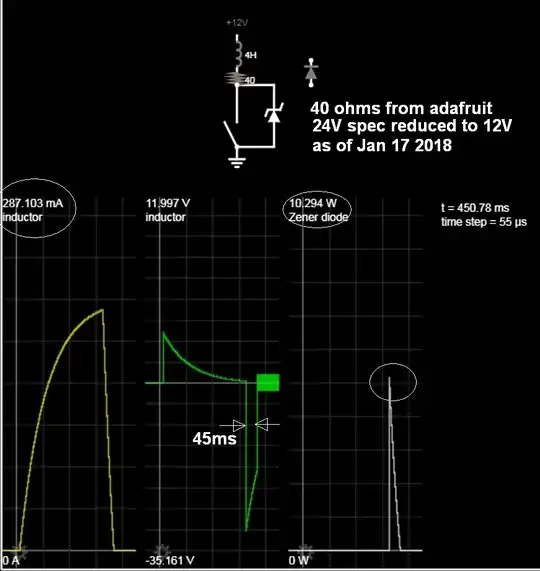

Alternative design with Zener across switch.
Vz=33V, Zzt=10 Ohms, Coil = 1H, 40 ohms
Found same photo from Adafruit with DCR spec of 40 ohms. Although assuming L=4H (typ) Tau=L/(DC+Zzt) is still 4/50=80ms the 33V Zener stops conducting reduces the conduction time to 45ms. enter image description here
Datasheet https://www.adafruit.com/product/412
