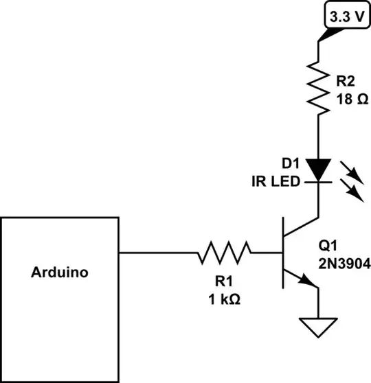

Why I should us a transistor to drive an IR LED?
I see many schematics which use the following circuitry:
If I connect the IR LED directly to an Arduino digital pin, it works. But with the transistor circuit, it works better.
Why is that?
(my value of R2 is just for show)
bitsmack
  • 16,931
  • 54
  • 111
The quick answer is that a transistor can provide more current than an arduino pin. This makes the LED emit more light.
