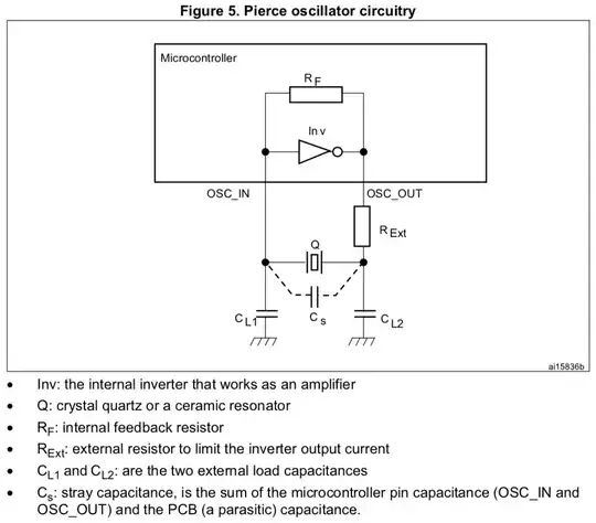

I've included a diagram of typical Pierce oscillator circuit taken from ST Application Note AN2867:
pierce oscillator circuitry
The note suggests that C_L1 and C_L2 should be chosen such that the following equation holds:
Since C_L1 and C_L2 are typically equal, this equation can be rewritten to solve for their value: C_Lx = 2(C_L-C_S).
As a rule of thumb, the stray capacitance is usually taken to be 2pF - 5pF, although I've seen a datasheet suggest 10pF as a rough estimate.
The question: By choosing an oscillator with a low load capacitance C_L, e.g. equal to the expected stray capacitance, C_Lx goes to zero. Is there any problem with choosing an oscillator with a small load capacitance and eliminating the need for the two capacitors C_L1 and C_L2 from a design by depending solely on the stray capacitance?

    @MichaelKaras The example in AN2867 solves for C_L1 and C_L2 assuming that they are equal, and all of the designs I've seen choose equal C_L1 and C_L2. I'd be interested in seeing documentation for a selection process that produces different values for C_L1 and C_L2. – mablem8 Apr 30 '19 at 20:47
  • @JRE Can you expand on your comment? Using the guidance in the datasheets, I don't see any reason why depending only on stray capacitance wouldn't work. In fact, the equations leave no other option for oscillators with very small load capacitances. – mablem8 Apr 30 '19 at 20:48

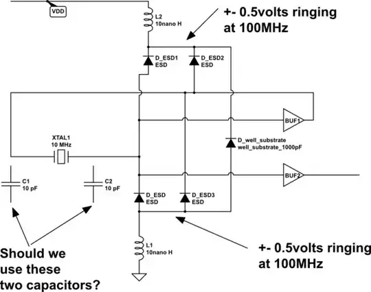

The ESD diodes are part of the stray capacitance. These, being installed on the silicon SUBSTRATE, inject all the MCU trash into the XTAL's energy storage loop.
You'll have lower jitter (phasenoise) if the ESD diodes are swamped out by external capacitors. The oscillator will build up the stored energy until cycle-by-cycle losses equal the cycle-by-cycle newly-injected energy.
Note you have the same resonant current circulating in both capacitors of the PI network. This can be a reason to make the Cinput (OSCin, CL1) be substantially smaller, so the voltage across Cinput is quite LARGE. Of course, smaller caps are more vulnerable to MCU trash injected thru the ESD diodes/structures. Experiment with this tradeoff.

  • One might indeed proceed to design 2pF or 5pF or 18pF capacitors into the copper foils. The areas involved make the "parasitic capacitors" very vulnerable to Efield aggressors which, again, increases the injected non-synchronous energy and thus boosts the (deterministic) jitter (phasenoise). – analogsystemsrf May 01 '19 at 15:29
  • The oscillator's PI network will have slow edges, perhaps 1 volt in 100 nanoseconds. A charge injection of 0.1 volt will cause 10 nanoseconds jitter. Is that a tolerable amount of clock edge jitter? – analogsystemsrf May 01 '19 at 16:36
