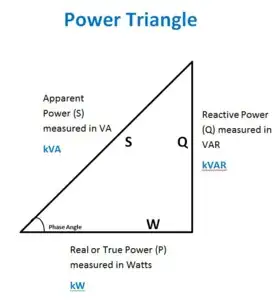

Power factor (PF) is defined as: \$\dfrac{\text{RealPower}}{\text{ApparentPower}}\$ where ApparentPower is simply the RMS voltage multiplied by the RMS current.
RealPower can be more complicated to calculate if the voltage and current are not perfect sine waves of the same frequency
power triangle diagram
(Image source: Envirotec Magazine - Monitoring power factor for effective energy management)
In the case where they are however from the diagram above we can see \$\text{RealPower} = \text{ApparentPower}\cdot \cos(\varphi)\$ and \$\text{PF} = cos(\varphi)\$
Where \$\varphi\$ is the phase difference between the voltage and current.

Best way to understand this is to think of Power Triangle.
Because true power and apparent power form the adjacent and hypotenuse sides of a right triangle, respectively, the power factor ratio is also equal to the cosine of that phase angle.
Power Factor of 1 implies that all power is utilized and there is no reactive power. This can be seen by realizing simple values:
  • PF = True Power/Apparent Power
  • PF = 150W/165VA
  • PF = 0.909, which can also be realised as cos(24.6) = 0.909
Looking from the graph above, you can see that as the reactive power is decreased in magnitude - the phase angle becomes smaller. With no reactive power component the angle becomes 0. PF of cos(0) = 1.

    That's all correct for sinusoidal voltage and current. What happens power factor when, for example, the current is non-sinusoidal as happens when there is an inverter, VFD or SMPS? – Transistor Apr 29 '19 at 09:42
  • Thanks for your answer! I understand that. It is written in the same manner in textbooks. If these two quantities are not equel in general case then I am interested what the difference is that – Salekh Apr 29 '19 at 11:41
