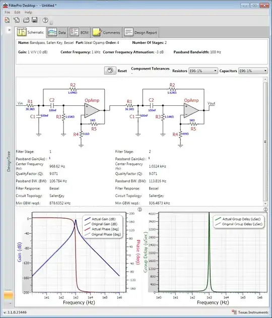

    You may need a faster opamp. Rejection bands require lots of gain (and thus lots of bandwidth) to push the rejection far far down. – analogsystemsrf Apr 17 '19 at 00:21

  • @analogsystemsrf has a valid concern. Since you have no limitations, consider using inductors & capacitors (and resistors)...rather than the more limited R,C filters of Analog's generated design. Doing so can ease requirements on the opamps. Understand that engineers often avoid inductors - they are less than ideal components - a design using them might be considered less elegant. – glen_geek Apr 17 '19 at 00:54
  • I can't think of a way to lead you to this with questions: design three 1st-order bandpass sections (assuming that when you say "3rd-order" you mean three resonant pole pairs), and just cascade them. Section A feeds section B feeds section C. – TimWescott Apr 17 '19 at 00:54

In order to design any filter, there must be realizable specifications and tolerances before designing on an implementation.
So far you have;
Specs
  • Filter Order N >= 3
  • Stop Band = 20 kHz
    But you need to include more.
  • Gain = ____ dB, inv. or non inv. optional)
  • fo = ______ Hz, center frequency
  • Rp = _____ dB, Allowable Passband Ripple e.g. 0, 0.1 to 3 dB **
  • BWp= ____ Hz, Passband ** ( which affects Q of each stage )
  • BWs= _____ Hz Stopband **
    • Asb= _____ dB, stopband **
  • Component Tolerances =____, R=5%,1%,0.5%,0.1%,0.01% C=10%,5%,2%,1%,0.5%
  • ___ GBW min of Op Amp or __ TBD depends on Q², fo, Gain
  • other ? DC Vref ? Single or split PS? tuneable?
Response options;
Bessel, Chebyshev 0.5dB, 1dB , Linear phase 0.05 deg, 0.5 deg, Butterworth, Raised Cosine, etc..... ** options above ** are more important for these
Configurations
  • single ended, differential, Multiple feedback
  • Sallen & Key
e.g. Gain =1 , fo=1kHz, Rp=0, BW=100Hz 4th order. GBW=1MHz, 1% parts, Sallen & Key
