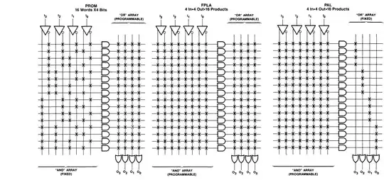

To summarize the link that @jonk put in a comment: There are three ways to implement a generic programmable sum-of-products (AND gates followed by OR gates) function. In historical order, they are:
- PROM Programmable Read-Only Memory - the word decoder (AND gates) are fixed, and the data (OR gates) are programmable.
- PLA Programmable Logic Array - both the AND gates and the OR gates are programmable. This allows more complex functions than a straight PROM allows with a much more efficient implementation.
- PAL Programmable Array Logic - the AND gates are programmable, but the OR gates are fixed. It was realized that the PLA was overkill for many simple functions that only needed a limited number of product terms per output, so fixing the OR structure allowed a much smaller chip.
The similarity of the last two names is mainly a historical artifact, and also probably a function of how the devices were marketed.

Why did the designers of such devices choose those close names for both of them?
My understanding at the time was it was really just about different companies and in particular trademarks for extremely similar technologies. Linguistically, there's hardly any difference between adjective + countable noun "logic array" and the adjective + uncountable noun ("array logic"). It's a question of minor stress. But there is potential an enormous economic difference if you can establish a valuable trademark.
Obviously it's true that there were the differences mentioned in the engineering, but basically they're the same thing, which slightly different restrictions in any given device. You also have to remember that it was common for programmable chips to be in sockets, and that very many different PALs could go in the same socket: which mean you could adjust the OR gates by choosing a different part, and plug it in later. Not post-build programmable, but certainly post-build changeable.
In my firm we called all of them "programmable logic" without much distinction -- because the "array" feature was an implemntation detail. And we'd choose whatever was the simplest, most available, or cheapest part for a given application.
You can see from MMI's explanation that both the PROM and the PAL can be considered a special cases of the fully-general PLA.
