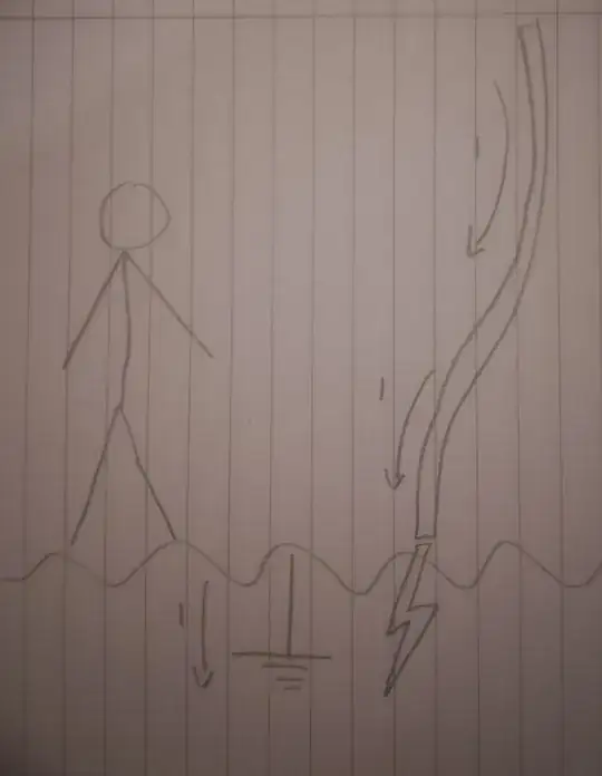

We've all seen this scenario in movies; somebody has to cross a room half filled with water and there is a dangling electric wire that shoots sparks everywhere. The poor person has to cross the room but cannot do so because if the wire hits the water he is obviously electrocuted since water is a conductor.
But is it so simple in real life? If I'm really standing in water in a room, and a high voltage wire hits the water, how does the electricity flow through me to electrocute me? Only my feet are touching the water, no other bodypart of mine is touching anywhere. And realistically there probably would be some piping etc. connected to ground somewhere that would conduct the current to ground. How would I be electrocuted if the current just flows past me?
I suspect this is similar to the well known situation of somebody dropping a hair dryer into a bathtub with a person in it. Why doesn't the current in this situation flow either from the live wire to the neutral wire or through the drain to the ground? Why does simply being in "high voltage water" electrocute me? (And yes, I know the scenario is not so likely with modern appliances but let's consider this in theory).

    The answer is: it depends, there are many variables involved like: distance between you and the wire, voltage on the wire, conductivity of the water, water level, material of the bath, if the bath is metal or conductive: how well is it grounded, is it painted. I could go on for a while. All this determines the amount of current passing through the person. Also thin persons can handle less current than "less thin" persons. There can be no clear answer. – Bimpelrekkie Apr 08 '19 at 11:26
  • Your ground symbol in the sketch implies that the power on the wire is referenced to ground. It may not be. The power on that line could be isolated from ground. – scorpdaddy Apr 08 '19 at 12:28

  • +1 for the sketch! – dalearn Apr 10 '19 at 11:19

Oh yes. The phenomenon is called "Electrical Drowning".
In this tragic case, a girl decided to dance in a fountain, unawares that the underwater lights had a ground fault. Her muscles contracted and she fell down. One friend went in to try to grab her, and she too lost control of her leg muscles and fell down. Her two other friends tried to rescue the first two.
Firefighters showed up, one tiptoed in, lost it and his friends yanked him out. The firefighters spent 15 minutes trying to find the shutoff switch.
The problem with falling down in water is that you drown. All four girls did.
In fact, multiple victims is often the only clue to an electrical drowning.
This is why any beachside installations now require GFCI and shutoff switches, and why you should not swim near a boat on shore power.
Why electrical drownings happen
You've seen problems involving grids of resistors. That's what water is, a 3-D grid of resistors, and you also are some of the resistors.
Electrical current travels all available paths in proportion to their conductance (1/resistance). 1-10 mA is enough to start causing problems for a sensitive person; 100 mA is lethal in its own right.
Electricity wants to get back to source (the pole transformer's neutral), and the NEC standard for a grounding rod is 25 ohms. You can do the math here.
Well, I get 120 V through a 24 ohm resistor = 5 amperes. So only a tiny fraction of that current need go through you to nail you. If we rely on that article's 20 mA, then 1/250 of the current is enough to drown you.
Note also: this is not nearly enough to trip a typical 13, 15, 16 or 20 A branch circuit breaker.
However, a GFCI breaker will trip at 6-8 mA. That greatly improves the prognosis. This narrows it down to a highly improbable combination of events where the current is naturally limited to less than 6 mA, and almost all goes through you, and you're ultra-sensitive.

In something like water electricity does not "flow to ground" in a neat straight line. There is a potential difference between sections of water radiating out from the HV contact point. That might also mean that your feet are at different potentials, and there will be current flow which could be fatal. This is one reason why cows in fields can be electrocuted by a nearby lightning strike. The voltage difference between their feet can be thousands of volts.

I think that the answer is pretty simple - you are a better conductor than fresh water. I read this somewhere and it made me giggle then: "Humans are just big bags of salt water", which is true. A current of 1 mA through the heart is enough to cause a heart attack, so at 220 V, 220 kΩ resistance is not enough. You are less than 220 kΩ, especially when in water. Skin is the only insulator we have.
I already posted that picture once in a question about electric eels:
enter image description here Source: phys.org Credit: Kenneth Catania
Electricity doesn't flow along a single preferred path, it flows in the entire water body with different intensities. If you happen to be in a path with high enough current, you'll get electrocuted.
An interesting corollary to this fact is that you'll get the worst shock when you and the water have comparable conductance. If the water is much more conductive than you, even high currents will only create a small voltage difference, which may not be harmful. If the water is much less conductive, the voltage difference may be huge, but the current will be limited.

    The current flowing through a body in water depends solely on its resistance and the sustained voltage, not (directly) on the resistance of the sorrounding water. The caveat "directly" is because a high resistance surrounding makes the potential difference at your body collapse (it happens in the high resistance part, and the current through your body making that drop happen may not be harmful). But the case that your body has a higher resistance than the surrounding won't have any benefit at all. (You'd need a power source though which can sustain the voltage in spite of the high currents.) – Peter - Reinstate Monica Apr 10 '19 at 09:59
  • "If the water is much more conductive than you, even high currents will only create a small voltage difference". I wonder if this is really the case. If we assume that there is a fixed voltage source that can produce any current needed, than a change in conductivity will have no influence on the total voltage potential. Lets look at the case where the body resistance is much larger than the water resistance. If the total voltage potential stays the same (and the water has uniform conductivity), then the voltage drop over a smaller section would also stay the same. ... – BrtH Aug 02 '19 at 21:08
  • ... Only when the resistance of the body is in the same range or smaller than that of the water, the voltage drop would change, because there is no more uniform conductivity. However, the voltage drop only lowers, and with it the current through the human. See this simulation: https://i.imgur.com/Cv9pVMW.png, the current through the human is the largest when the resistance of the water is smallest. This also holds when we use a different ratio of the resistances of R1, R4 and R6 instead of 1:1:1. – BrtH Aug 02 '19 at 21:11
  • @BrtH It's all about assumptions. Your simulation assumes the voltage source can produce an unlimited current. In which case I fully agree. – Dmitry Grigoryev Aug 07 '19 at 07:21

You are electrocuted when a current of more than 100 mA flows through you. The wire does not do the electrocuting, it only connects you to a current source.
  1. If there is no current source, there is no current. So go ahead and grab that wire. Nothing will happen. On the other hand, if the wire is connected to a current source, like the 220 VAC power to your clothes dryer, you are likely to die.
  2. There is nothing magic about a "dangling" wire. If the wire is rigidly supported, it will kill you just as dead as if it were dangling.
  3. To determine if the electric field inside water that is conducting can kill you... that requires a 3 dimensional finite element analysis of the voltage distribution within the body of water. If the wire is hot and is touching the water, you best stay out of it. On the other hand, near the edge of the water, where it is very shallow, the current will be minimum. So you might stick your toe in and see if you can feel anything before proceeding further.
  4. You can increase the lethality by adding ions to the water. Salt will do this, or any strong acid or base.
  5. Some utility wires are not wires at all and carry no current. They are fiber optic cables and are harmless. But don't bet on it.
