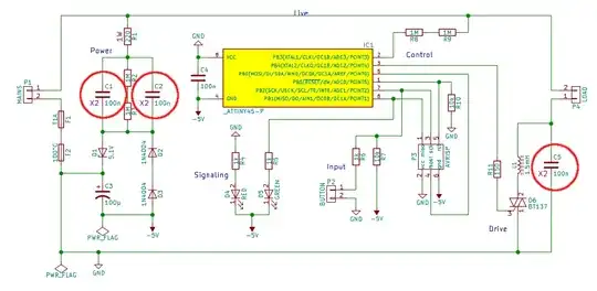

A few years ago, I designed an MCU-controlled dimmer driving a 150W mains halogen lamp. This is in Western Europe; 50Hz 230VAC. It uses X2-rated capacitors as capacitive droppers for the power supply, and another X2-rated capacitor for interference suppression:
Circuit diagram of MCU-controlled leading-edge phase cutting dimmer
The dimmer has gradually started misbehaving, and on debugging I found that all of the X2 caps have died (meaning they have less than 10% of their rated capacitance remaining):

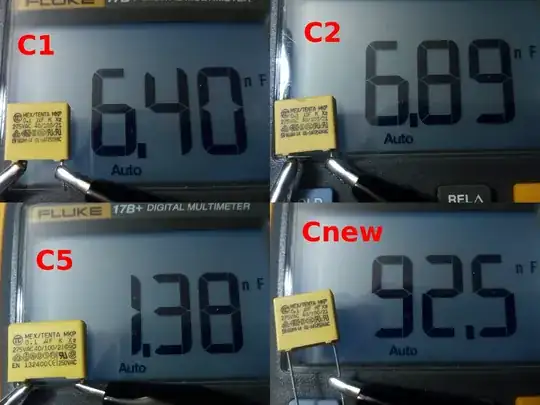

Pictures of C1, C2, C5, Cnew
The caps in the picture:
  • C1, capacitive dropper, should be 100nF, measures 6.4nF
  • C2, capacitive dropper, should be 100nF, measures 6.9nF
  • C5, interference suppression, should be 100nF, measures 1.4nF
  • Cnew, fresh-ish cap from my junk bin, measures 93nF
All of them measure open circuit (>40MΩ) on resistance.
C1, C2, and Cnew are labeled MEX/TENTA MKP 0.1µF K X2 275VAC 40/100/21 [approval logos] EN 60384-14 01-14 250VAC; 275VAC nominal rated (significantly higher withstanding voltage, datasheet here). They are all from the same batch, bought in Sep 2016. I suspect 01-14 is a date code, so they'd be from early 2014.
C5 is from the same brand; it has virtually the same markings (except EN 132400), but is physically larger. I got it as part of some Velleman kit years ago, where it was also used as a suppression cap. No datasheet.
What caused these caps to lose their capacitance?
  • Is this deterioration normal behaviour for X2 caps? The dimmer saw a lot of use, being powered for an estimated 7000 hours.
  • Should I have derated the caps more? I agree 230VAC is pretty close to 275VAC, but as I understand it that is their nominal rating, and they should be able to handle transients way above that. Also, 275VAC seems by far the most common rating available on Digikey and the like.
  • Am I using the capacitors wrong somehow?
  • Are these capacitors from a bad brand/series/batch?
Update: Possibly relevant: the dimmer is powered through a mechanical switch, and has seen an estimated 1000 on/off switch cycles over its lifetime. Perhaps the transient from mechanical switching played a role?

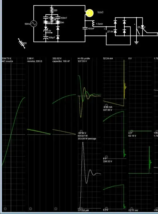

In the fine print TENTA specs indicate a MAXIMUM RISE TIME 250Vac:120V/microsecond. This implies the maximum current it can handle using Ic=CdV/dt with dV/dt rated at 120V/us max.
So how is the pulse current in this design? C5 across Triac may see continuous current spikes of about 1 A when operating the bulb at 90 deg phase control on peak voltage.
This will significantly reduce the life of the capacitor.
For a 150W Tungsten lamp operating at 240Vrms 340Vp at 90 deg phase on Triac, the bulb draws about 100W and has cooled down to a dim 1200'K with R= 240 Ohms and C5 across Triac and 1.5mH inductor discharges the 350Vp cap voltage with the resistance of the Choke and triac

    "This implies the maximum current it can handle using Ic=CdV/dt with dV/dt rated at 120V/us max." - I'm slightly confused though; plugging the dV/dt into the capacitor equation, along with 100nF, suggests to me a maximum current of 12A; your calculations (and my measurements, I'll post an update later) suggest peak current is only ~10% of that... – marcelm Jun 18 '19 at 21:42
    @marcelm it depends on the network impedance feeding the caps with R,diode Cap. and the energy is a product of ESRI^2t absorbed in the caps. They are also rated for ripple current which will be excessive with Triac controlled Halogens.. Your calculation assumed none of the other current limit R parts. yes the caps still failed and the losses may be computed in each to prove why they failed. – Tony Stewart EE75 Jun 18 '19 at 21:47
    Note the cap ESR of 10m dissipated >600W peak for only a few microseconds. – Tony Stewart EE75 Jun 18 '19 at 21:49
    Where does the >600W peak come from? ESR*I² = 10mW for ESR=10mΩ, I=1A... – marcelm Jun 20 '19 at 13:53
    the dV/dt voltage swing across the Tenta cap specs with 10mOhm ESR are shown in my middle plots (50us/div) – Tony Stewart EE75 Jun 20 '19 at 16:19
    What's that simulation tool you used? – mrbean Aug 17 '20 at 15:45
    Falstad’s web simulator is the bee’s knees ideal reactance add your ESR, DCR all based on physics. Not part numbers except diodes. http://tinyurl.com/yyqdpqc9 – Tony Stewart EE75 Aug 17 '20 at 17:30

    Are you sure these caps are rated for Pulse charging/discharging applications? I think it is for RF coupling or RFI suppression NOT switching 150W loads from Triacs or Offline diode pulse regulators that draw 10x peak/avg current for 10% ripple. – Tony Stewart EE75 Apr 03 '19 at 21:11
    Obviously the parts cannot tolerate this application and are all damaged. Self healing is only for random lightning events not absorbing 1~2A pulses every cycle. – Tony Stewart EE75 Apr 03 '19 at 21:33
  • Even a higher voltage rated cap is not enough here, since the issue is the maximum current the cap can handle (in the order of 1A). You need a cap that can deal with such current without damage. – xryl669 Apr 03 '19 at 21:43
  • @SpehroPefhany Hmm, the dimmer is powered through a mechanical switch (approximately 1000 on/off cycles over its lifetime), I'm sure mechanical switching produces transients. Could those be the cause? Perhaps I should make a test rig for that. – marcelm Apr 04 '19 at 07:29
  • @xryl669 Where are you getting the conclusion that the current through the cap exceeds 1A? – marcelm Apr 04 '19 at 07:30
  • @marcelm , when cap is at Vpk (90deg) and then if Triac triggers the discharge current exceeds 1A which is verified in my simulation. If transients exceed BDV of 220 resistor, it also acts like a Triac (arc) and surges the Cap divider circuit for 5V, – Tony Stewart EE75 Apr 04 '19 at 12:48
  • What is rating for R1? 500V or ? – Tony Stewart EE75 Apr 04 '19 at 12:54
  • @SunnyskyguyEE75 I am dubious the current on the snubber is the main issue, given the other two caps are deteriorating similarly. OP might not even have noticed if the power supply didn’t go janky. That said,you’re right the snubber should have sone hundreds of ohms in series. – Spehro Pefhany Apr 04 '19 at 13:08
  • The discharge current on C5 is one issue, and R1 overvoltage charge surge on C1,C2 are separate issues, unless special I would expect R1 rating to be 350V to 400V – Tony Stewart EE75 Apr 04 '19 at 13:16
  • @SunnyskyguyEE75 Sadly, I have no datasheet for R1, it came from the same Velleman kit as C5, where it was used in a snubber on mains, so I'd hope it was appropriately rated for mains voltage. It's a 11mm 1W resistor. I'm assuming metal-film 400V operating voltage. – marcelm Apr 04 '19 at 19:25
  • @SpehroPefhany I agree with EE75 that there could be totally separate causes for the deaths of C5 and C1/C2. I'm inclined to put series resistance on C5, and do some test setup to try and find the cause of C1/C2 death. It'll be a long-term thing, but I'd like to get to the bottom of this and understand where I went wrong :) – marcelm Apr 04 '19 at 19:29
