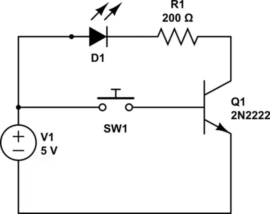

I have created the following circuit to better understand how to use a transistor as a switch*.
I've been struggling with understanding datasheets for transistors.
schematic

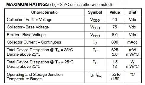

Datasheet states EB maximum voltage
According to the datasheet the emitter-base maximum voltage is 6.0 V. In my circuit I am only applying 5 V. From reading the datasheet (below) would you expect that to be too much?
Also, I see that the secondary (output) circuit of collector-emitter can supposedly take up to 40 V(?). Does that mean I should be able to drive a circuit on the collector-emitter side that has up to 40 V on it?
Am I reading the datasheet properly?
I'm wondering because in my other (referenced question) circuit the transistor became very hot with only 5 V -- but that may have been due to being wired improperly, I'm not sure.
2N2222a max ratings

    Visualize a diode where the arrow is in a BJT. The transistor will inherently constrain the base voltage to be at most one diode voltage (0.7V) above the emitter. Here you're trying to apply 5V. To limit the current, add a base resistor. The resistor will be 5V on one side and 0.7V on the other. – BB ON Apr 01 '19 at 18:35
  • @BBON So it's a ratio between base and emitter side? And I need to increase the emitter side since the base side is so high? If I had 4.5 volts on the emitter side then maybe the base side would be ok? I'm guessing here. Still not sure. I'm sorry, I know I'm missing something foundational. EDIT - Also everyone always mentions 0.7V and I'm not sure where that comes from. Part of my missing knowledge. I don't ever see that in the datasheet. thx – raddevus Apr 01 '19 at 18:40
    Everyone "always mentions 0.7V" because the base-emitter junction is a PN junction exactly like a diode. It becomes forward biased at that voltage and there it is essentially at maximum conductivity. Applying 5V can't "turn it on" more. The base resistor defines the current allowed to enter the base. By applying a small base current, you get a large collector-emitter current gain. Please read BJT theory. – BB ON Apr 01 '19 at 18:46
  • @BBON Very good explanation of "forward biased at that voltage...applying 5V doesn't make it conduct more". That helped a lot. I will read more on BJT theory. I've read things like https://learn.sparkfun.com/tutorials/transistors/all but trying to then read datasheet was difficult for me. Thanks again. – raddevus Apr 01 '19 at 18:50
    No problem. A quick solution is to just add a resistor between SW1 and the base. Try 1K. – BB ON Apr 01 '19 at 18:57
  • @raddevus: See if my non-return valve / diode illustration is of any help. – Transistor Apr 01 '19 at 19:25
  • @Transistor That's a good read. Thanks for sharing. I really liked the valve illustration. Very illuminating. – raddevus Apr 01 '19 at 19:39
    You accepted my answer to your previous question, which explained why you need a resistor in series with the base. In your comment you said you had built my proposed circuit and it worked. Why are you trying without a base resistor again? – Peter Bennett Apr 01 '19 at 20:18
  • @PeterBennett Sorry for the confusion I was wondering which way to ask this question. This question was really all about understanding the transistor datasheets. Even with the great answers I've received here I'm still trying to understand what the datasheet means and how I apply that knowledge. Also without your great answer on the first question I never would've been able to get to this question. – raddevus Apr 01 '19 at 20:34
    @BBON I don't agree with "applying 5V can't turn it on more". If you apply 5V across the base-emitter junction, it will briefly turn extremely on, before turning extremely off with a puff of smoke as a side effect. – Hearth Apr 01 '19 at 20:57
    @raddevus 0.7V is about the amount of "bias voltage" must exist across a silicon diode before it stops blocking and starts passing normal current. It's due to the material used to make the semiconductor. For a diode made out of germanium, this bias voltage would be about 0.3V. I'm learning, too. – Suncat2000 Apr 02 '19 at 15:30

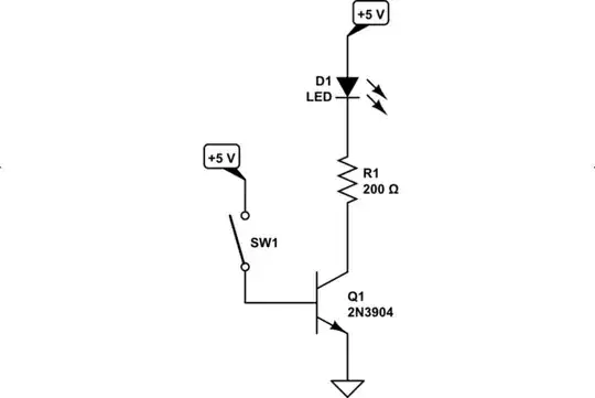

This is your circuit drawn as a schematic to read for understanding rather than as a wiring diagram (which is more about getting everything connected and not so much for understanding it.)
schematic
The idea illustrated in your diagram, where the LED and a current-limiting resistor are placed in series in the collector circuit, is a common (and reasonable) approach. The BJT is operating as a "semiconductor switch" and this is one of several approaches for that behavior. So far, so good.
But the idea of directly tying \$+5\:\text{V}\$ to the base, when the emitter is also nailed down to ground, is not common and it's not good. This directly places a full, forward-biased \$5\:\text{V}\$ across the base-emitter diode. Keep in mind:
  1. You only need from as little as \$600\:\text{mV}\$ to perhaps as much as \$900\:\text{mV}\$ (in most cases) to use the BJT as a switch.
  2. For each additional \$60\:\text{mV}\$ (typically) you will get 10 times as much collector current (if permitted by the circuit portions connected to the collector) and 10 times as much base current (always possible.) Broadly speaking, the base current will be exponentially related to the applied forward-biasing voltage across the base and emitter.
You were applying \$5\:\text{V}\$!! This is way, way, way above what you should have been using. So the BJT was being literally flooded with base current. Of course it was getting hot! It was dissipating serious power. Might have even damaged the device (I'd probably throw the part away, in fact, after doing something like that.)

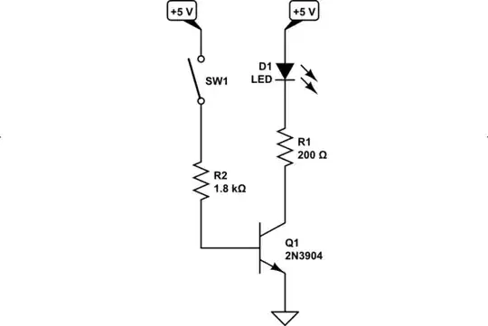

This is why a resistor is often applied to the base circuit.
schematic
simulate this circuit
The base resistor's voltage drop is a simple linear relationship to the current passing through it. The BJT's base-emitter junction current is an exponential relationship. So as the BJT's base-emitter diode junction tries to rapidly increase it's current, the resistor in series with it opposes this rapid change by dropping voltage. Very quickly, it will turn out that the resistor drops enough voltage so that the base-emitter junction's voltage is close to where it should be.
By using a resistor, you permit the base voltage to "find a stable and reasonable voltage drop" for its operation.
As others have pointed out, the Maximum Ratings section also specifies an absolute worst case reverse-biased voltage for the base-emitter. This is because the base-emitter PN junction diode can't handle a lot of reverse-bias voltage in a typical BJT. Diodes used in bridge rectifiers can often handle very large reverse-bias voltages across them. But not so much with BJTs. They aren't designed to handle much of that kind of stress. Instead, they just break down and avalanche. So the ratings there tell you what to watch out for. Often, people will add a separate diode (oriented opposite to the forward direction of the base-emitter junction of the BJT) going from base to ground in a case like this to protect the BJT ... just in case.

\$V_{EB}=V_E-V_B\$.
The datasheet is saying the emitter can be (up to) 6 V above the base, not that the base can be 6 V above the emitter.
With \$V_{BE}\$ (\$V_B-V_E\$) at 6 V, an absurdly large current will flow into the base and burn out your transistor very quickly.

    @raddevus: To be clear - $ V_{EB} $ is the maximum reverse voltage the base-emitter junction can withstand (where forward is the normal base current direction). – Transistor Apr 01 '19 at 18:10
Bi-Polar transistors multiply current. A small current from the Base to Emitter causes a large current from the Collector to Emitter. On the ON Semi Datasheet, see hfe on page 2 for the gain, which is between 50 and 375 for this transistor. Realistically it is probably ~ 200. This means that if you have a current flow of 1 mA in the base-emitter, there will be a current flow of 200 mA through the collector - emitter.
The Base Emitter junction is a small diode with a reverse breakdown voltage specified at 6 V. This circuit has no reverse voltage, BUT with 5 V on the Base and ~ 0.7 V drop across the B-E junction, you will have 4.3 V into a short circuit (~ 0.05 Ohms for wiring) which is 56 Amps / 369 Watts! Neither the transistor or the power supply will last more than a microsecond.
That is why you MUST PUT a current limiting RESISTOR in series with the BASE. A value of 430 Ohms would be ~ 10 mA Base current, but.... Use a standard 1.5k (1.47k) Ohm which will allow 2.67 mA Base current which means the Ic current will be ~ 534 mA (with Hfe =200). This is less than the 600 mA Ic allowed by the data sheet. The 200 Ohm resistor will limit the LED-C-E current to 14.5 mA.
