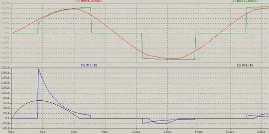

Many, if not most of home appliances have the supply directly form the mains, meaning -- in simple terms -- a bridge rectifier directly to the AC input and the a capacitor. Some of these supplies will risk deteriorating if the currents through the input stage is larger than it was meant to be.
For example, if there were a square-sine (think UPS waveform) the bridge and the capacitor would "see" a sudden current inrush and a 5ms (typical for 50Hz) conduction time, which can prove critical.
Here are some waveforms to help visualizing:
waveforms
The upper traces are the voltages, compare the sine and the square. The lower are the input currents: the black one is from the sine-wave, the other from the square wave. The loads are the same bridge and R=100\$\Omega\$ parallel with C=1mF (ESR=0.5\$\Omega\$), random example values.
In general, it's preferable to have a sine whenever possible,not only for "sensible" equippment.

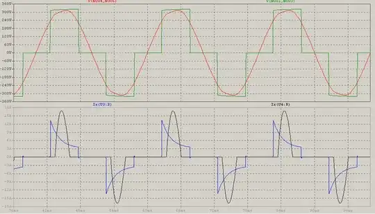

Just to grin a little, here's how the startup currents/voltages look like:
grin
