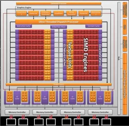

But that's nothing. A modern graphics card has a GPU (which used to stand for Graphics Processing Unit, but now stands for General Processing Unit). These are often wide SIMD implementations, capable of branches, loads, and stores on 128 or 256 bits at a time. Intel's Larrabee prototype microarchitecture includes more than two 512-bit SIMD registers on each of its cores.
GPU SIMD
Please note that SIMD is not to be confused with multi-core. Each core of a CPU will have its own wide ALU capable of adding together a set of integers.
