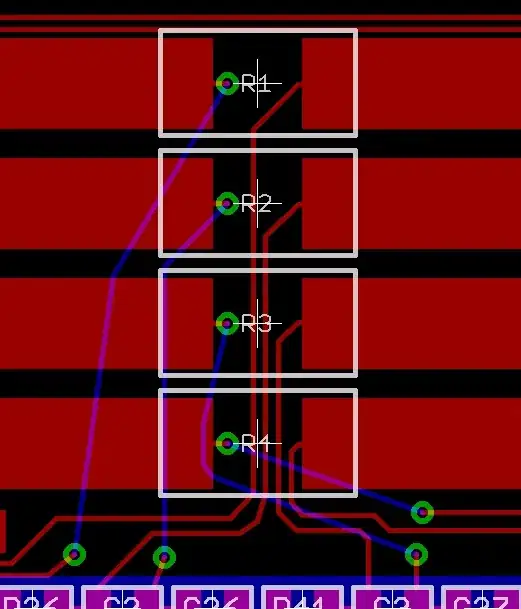

This is a aside relative to the question, but adds to what Russell said about low value current sensing resistors.
When using very low value resistors to measure current by generating a voltage proportional to that current, you have to consider the resistance of the connections to those resistors. One way to get around this is to do what is called a "4 wire" measurement. You run the current thru the sense resistor normally, but measure the voltage differentially with separate feed lines immediately accross the resistor. With proper differential measurement, this cancels out any additional voltage drops created by that current in the high-current connections to and from the resistor.
Here is a example of a 4 wire measurement:
R1-R4 are 100 mΩ current sense resistors that can carry as much as 4 amps in this case. The system needs to react to these currents at 1/4 mA resolution at the low end. The left side connections are all actually ground and are tied together shortly to the left of this snapshot. Even though most of the ground path is isolated, imagine the problem of multiple amps running thru the top three resistors and trying to distinguish between 1/4 mA and 1/2 mA flowing thru the bottom one. Those amps thru the top resistors will easily cause a ground offset at the bottom one well larger than the voltage drop caused by 1/4 mA accross R4.
The solution is the 4 wire measurement technique. Note the two wires coming from the inside connection of each resistor. Those go to what are essentially differential amplifiers that only respond to the difference of the voltage between the two wires. Those wires can be small since they are carrying little current. Their purpose is only to report the voltage to the diff amp.

  • Why is the reason that traces on the bottom layer have weird angles and do not go as close as possible to the matching trace on the top layer, since they will go to a differential amplifier? Is that not critical that much? – abdullah kahraman Oct 04 '12 at 14:19
    @abdullah: In some cases that would matter, but in this case the signals are very low impedance and noise pickup isn't a issue. – Olin Lathrop Oct 04 '12 at 15:41
