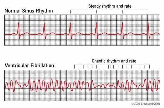

Once started, the chaotic rhythm known as ventricular fibrillation (VF) will often not stop by itself without external intervention - usually a very high magnitude electric shock from a defibrillator*- whose purpose is NOT to supply a heart start signal but to FULLY STOP the fibrillation rhythm so that the normal heart waveforms (normal sinus rhythm) can be restored.
*A defibrillator is usually a purpose designed item of medical equipment. In an emergency any source of significant but not too-significant electrical energy can be used and *may work. Risk of causing death or injury by this means is high and the risks of acting or not acting need to be weighed. (In a long ago movie the 'hero' used a mains cord from a torn apart table lamp as a defibrillator to successfully save a life. You'd need to be brave, desperate and lucky to perform such a feat successfully. In some cases it may be the best choice :-(.)
Normal sinus rhythm (NSR) vs Ventricular fibrillation (VF)
