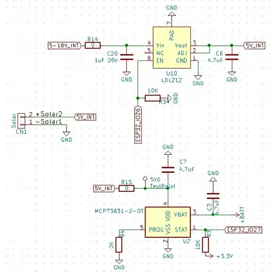

I have a solar panel and an external power source feeding into a DC converter (U10) that are both used to feed a battery charger (U2):
In a previous design I used 2 schottki diodes to prevent back feeding from solar to U10 and from U10 to solar.
But as the schottky has a voltage drop I would like to use a different solution with as little power loss as possible.
Any tip on how to design this?
Thx!
Jeroen

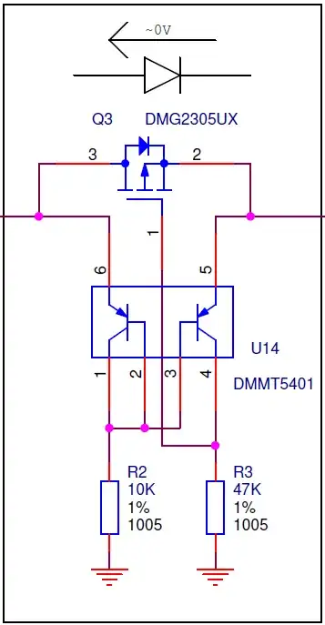

  • Using an ideal diode. The circuit generates only 20mV voltage drop. – Marko Buršič Feb 28 '19 at 11:13
  • just wondering.... suppose the external power is connected AND solar panel is generating a minumum amount of power and gets to 3 volts, it opens the diode. Will the higher voltage on "OUT" pin of the diode close the ideal diode preventing feedback to the solar panel? – Jeroen Feb 28 '19 at 12:07
  • Ideal diode circuits for example LTC4358 do always apply such voltage on gate, so that there is a minimal yet operational/detectable forward voltage drop. It works as variable resistor, if the voltage tends to be smaller or even negative it forces the MOSFET to reach high resistance and stop conducting. – Marko Buršič Feb 28 '19 at 12:37
You can use a mosfet to act as a diode like in this article
It is also covered in this post check the answer of Russel which link to this article
Using a MOSFET in place of a diode provides a resistive channel so that voltage drop is proportional to current and can be much lower than for a diode.
The question is also discussed here
