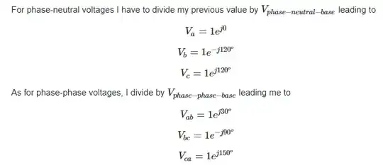

For phase-neutral voltages I have to divide my previous value by \$ V_{phase-neutral-base}\$ leading to
$$V_a = 1 e^{j0}$$ $$V_b = 1 e^{-j120^o}$$ $$V_c = 1 e^{j120^o}$$
As for phase-phase voltages, I divide by \$V_{phase-phase-base}\$ leading me to
$$V_{ab} = 1 e^{j30^o}$$ $$V_{bc} = 1 e^{-j90^o}$$ $$V_{ca} = 1 e^{j150^o}$$
Now my question is: why if I apply the formulas $$V_{ab} = V_a-V_b$$ $$V_{bc} = V_b-V_c$$ $$V_{ca} = V_c-V_a$$ using pu values the equations don't verify. Is it because I use different base values for each and this is just a question of proportionality?

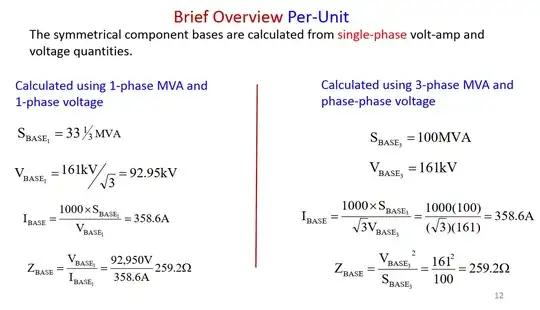

Your work is good. You are using 2 different voltage bases to get your results (pasted in below). That is why they are different in per unit.
If you take the results of your calculation using the phase-neutral voltages (Va-Vb) and convert them to the ph-ph voltage base you used, then they will agree. In other words, the results of Va - Vb is 1.73 per unit in magnitude. That is on a voltage base of 220kV/1.732. To convert that per unit result to the ph-ph base you used above, multiply by (220kV/1.732 divided by 220kV).
The ph-ph voltage base is root 3 larger than the phase-neutral. When working problems - do not mix. Just use one voltage base and carry on. That way, when you convert back to actual volts you won't make a mistake.
UPDATED: Showing base calculations.

    Hello! Thank you for your answer. Ok, I think I get it: because, even though some are phase-phase and others are phase-neutral, they are still voltages, and therefore, the same base must be used; however in my other calculations, I'm computing currents and impedances, and therefore, adding components in phase-phase base will produce me coherent results, since the current base and the impedance base were derived from the postulated voltage phase-phase base. – Granger Obliviate Mar 01 '19 at 01:53
    Granger - i updated my answer to show base calculations. When you pick a ph-ph voltage base you automatically set the ph-neutral base because they are related by root 3. So, if you calculate the current and impedance base quantities with either approach you will get the same results. – relayman357 Mar 01 '19 at 15:59
