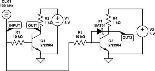

The harder the gate of a MOSFET is driven to turn it on, the longer it will take for the MOSFET to subsequently turn off. Performance may be improved by adding circuitry to limit excess gate voltage, though doing this without increasing quiescent power dissipation is tricky.
I don't know what exact techniques are used in CMOS to prevent oversaturation, but low-power Schottky devices based on bipolar junction transistors may provide a useful analogue. Consider the two simple inverters shown below:
schematic
The inverter on the left is simpler than the one on the right, but if one runs the simulation, one will see that the adding the diode allows the circuit on the right to switch off much more quickly than the one on the left.
In the BJT-based inverters below, the Schottky diode will slightly increase the power dissipation in R3, but such increase will be tiny compared to overall power consumption. In a CMOS device, simply clamping the gate voltage would increase power dissipation, making it necessary to use other, more sophisticated, approaches.

  • I don't recall MOS having charge-storage slow-down behavioral issues. – analogsystemsrf Feb 23 '19 at 04:45
  • For small MOSFETs, adding extra circuitry to bias things optimally probably isn't useful, but big MOSFETs are going to at minimum have gate capacitance, and I think they have other design issues beyond those, though I don't know exactly what they are. Using a four-transistor NAND gate feeding a two-big-transistor inverter (or even two big paralleled groups of transistors) would likely not yield as good performance as could be achieved with better control of gate voltages. – supercat Feb 24 '19 at 07:25
