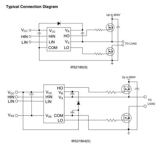

I have 2 different versions of a high and low side driver; IRS2186 AND IRS2186. I have attached the typical connections, taken from the data sheet (data sheet: https://www.infineon.com/dgdl/irs2186pbf.pdf?fileId=5546d462533600a40153567716c427ed).
IRS21864 has an extra pin Vss which is the logic ground but otherwise the connections are the same (just laid out slightly differently in the diagram). Both drivers should perform the same function so I was wondering what benefit having a separate power and logic ground achieves?

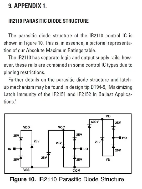

    I'd think it is meant for allowing isolation between logic ground and the negative power rail in applications where these 2 can't be connected together (class D amp comes to mind). – Unimportant Feb 22 '19 at 18:03
  • I don't see how that's possible since the driver is neither galvanically isolated or floating. The datasheet specifies that the that Vcc - 20 < Vss < Vcc +0.3", and "-0.3< Vcc < 20", where Vcc is measured relative to COM. So if Vcc < 20V, it allows Vs to be a little bit more negative than COM, but not enough to actually use a negative power rail. – DKNguyen Feb 22 '19 at 20:12
  • The application note DT97-3, Figure 10 shows how COM and Vss are connected together. – DKNguyen Feb 22 '19 at 20:15

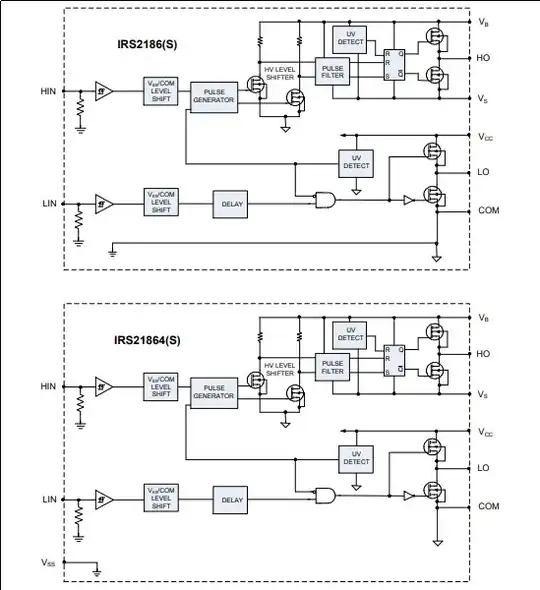

If you review the internal block diagram, the key difference is the internal break between COM and the "ground" connected used to reference the command.
This is sometimes beneficial if aspects of hte design could result in the return current going via the control signal 0V, or if there is expected to be some low-side SOURCE bounce (say if there is a low-side current sense resistor)
This allows for isolated operation, if controller and load have different ground references. There are lots of reasons why this may be necessary, for example when the controller has a different power supply, or when the load generates lots of noise on the supply rails.
