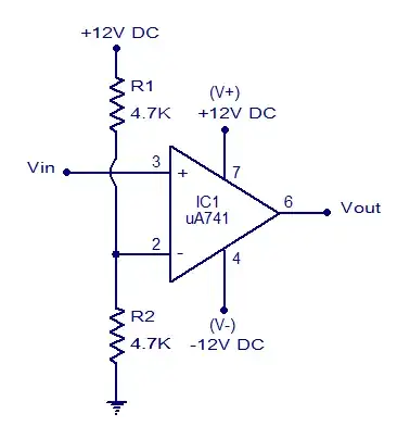

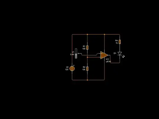

enter image description hereI made this circuit but no matter what the input Voltage is, the output stays high and the led lights. Is it because of the offset voltage ? And where to connect the offset nulls to make the output zero? It did not work when I connected the to ground enter image description here

  • What LED? Use the schematic editor to create a complete and accurate depiction of what you built, and also we need to know the input voltage range you applied. – Spehro Pefhany Feb 22 '19 at 09:47
    What are "offset nulls" ? (I know what you mean but I want you to explain better what you want). There is no LED in the schematic. What is the circuit supposed to do? A 741 is an opamp not a comparator. Connect what to ground? Also go read: https://electronics.stackexchange.com/questions/304521/reasons-not-to-use-a-741-op-amp/304634#304634 – Bimpelrekkie Feb 22 '19 at 09:48

    Gh, if you don't show us the whole circuit, or at least the while relevant circuit, we are forced to guess what it going on. The output is "fed" to an LED. That could mean many different things. Just show it with a diagram. – Bort Feb 25 '19 at 13:50
  • i put the simulation of the circuit just as i did it – Gh-B Feb 25 '19 at 14:46

    Your two schematics are not the same. The one you used in the simulation is extremely unlikely to work, the other one clearly does. – Edgar Brown Feb 25 '19 at 18:30
  • i didi the two circuit but u say the second one should work but it doesn't . i just read that the 741 can be used as a comparator and wanted to try but i think it doesn't work – Gh-B Feb 26 '19 at 08:32

As for your question, since the output hits to the positive supply rail when Vi-neg = 6 VDC regardless the value of Vi-pos, the source of the problem shouldn't be the offset voltage.

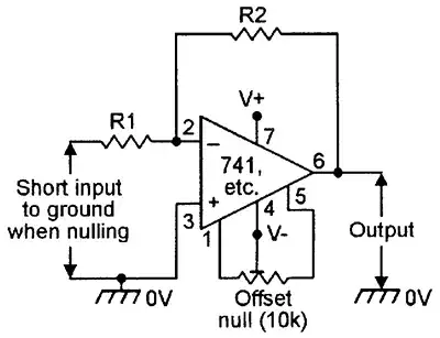

You may try adding a potentiometer to zeroe the Vos like following anyway:
