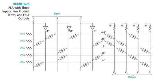

In a PLA, the switching elements in the wired-OR array are oriented as shown on the right of the figure (from Fundamentals of Logic Design, Roth/Kinney, 6th Ed, p.264). A logic 1 current appears to flow in the direction of the arrows, from word line to bit line.
However, the switching elements in the wired-AND array (left of figure) are oppositely oriented, so that a logic 1 current from an input line to a word line seems to need to flow against the direction of the switching element.
No explanation is given for this in the text and I've been unable to find any discussion online. Can anyone explain the reason for, and working of, the oppositely-oriented switching elements in the wired-AND part of the PLA?
Roth/Kinney, Fundamentals of Logic Design, 6th Ed. (2010), Student Edition, CENGAGE Learning, Figure 9-25 (p.264)

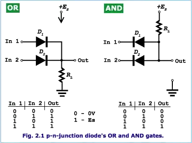

    Isn't it just due to the fact that pull-down resistors are used in the OR array whereas pull-up resistors are used in the AND array? – DKNguyen Feb 21 '19 at 00:17
    Think of the little boxes with arrows as diodes. Do you understand how to make AND and OR gates with diodes? – Dave Tweed Feb 21 '19 at 00:40
    Note that this is just a conceptual drawing. In any real PLA, the matrix on both sides would be implemented as NAND functions, taking advantage of De Morgan's laws. – Dave Tweed Feb 21 '19 at 01:21
You're meant to consider the drawing as an example of resistor diode logic.
Resistor Diode And/Or
Selective placement of the diodes configures the intermediate signals and the outputs. It's a little confusing because the grounds are towards the top of the figure on the right.
