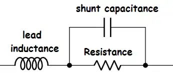

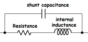

Resistors In this case, define a subcircuit such as presented in this question/answer Equivalent circuit of a non-ideal resistor, modeling the parasitic elements.
R parasitics subcircuit 1 R parasitics subcircuit 2
The model which suits your specific resistor construction and application is up to you to choose.
