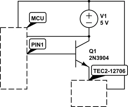

I have ATMEGA328 (running on 5V) connected to a C4793 NPN transistor which controls the TEC1-12706 thermal component.
I'm using the code below to turn the transistor on and off:

schematic
Everything is working great, except that the thermal module only gets 0.6A of current, even though the datasheet of the C4793 transistor states that it can handle 1A of current.
If I connect the base of the transistor directly to the VCC, I get 1.07A to the thermal module, which is exactly what I need.
I can't understand why I only get 0.6A when doing the same thing from the ATMEGA328. I thought maybe it's because ATMEGA328 puts out only 20mA from the PIN, but isn't the transistor triggered by the voltage instead of current? Any suggestions please? Thanks!
Kristian
  • 29
    Please provide a schematic to show how you have connected things together. There is a built-in schematic editor you can use to add the schematic to your question. – Elliot Alderson Feb 07 '19 at 12:56
  • @ElliotAlderson Thanks for the hint, doing that now. EDIT: sorry can you please tell me what component can I use for MCU? I can't seem to find anything related to it – Kristian Feb 07 '19 at 12:57
  • What led you to believe that a BJT operates with voltage instead of current? https://www.mouser.com/catalog/specsheets/toshiba_2SC4793.pdf The third graph shows hFE vs Ic. The gain is with respect to base current. This is a particularly bad datasheet, and it is missing the saturation current plot. But, either way, I would not use this transistor for over 400 mA (at least for switching, linear use may be OK). The hFE drops sharply after that. – Indraneel Feb 07 '19 at 13:01
  • What’s your base resistor value and hFE of the NPN? Any reason why you don’t use a MOSFET instead? – winny Feb 07 '19 at 13:02
    Just label a wire to show that it is the signal from the microcontroller, but be sure to also show us how all of the grounds are connected together. – Elliot Alderson Feb 07 '19 at 13:04
    You need a resistor from uC to base of transistor, or the uC pin will be toast. Minimum value of resistor in ohms = (5.0-0.7)/0.02 – Indraneel Feb 07 '19 at 13:46
    "If I connect the base of the transistor directly to the VCC ..." - That's a good way to destroy a transistor! (most BTJs are not rated for high base currents) – marcelm Feb 07 '19 at 15:08
    Your schematic makes little sense. Are you sure your voltage source is the right way around? – Hearth Feb 07 '19 at 15:31
  • @Hearth I think the transistor is the wrong way around. But I assumed it to be high side switching. Either way, to make this work, a darlington is called for. – Indraneel Feb 07 '19 at 16:03

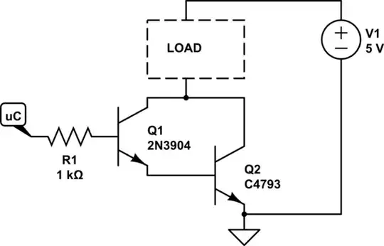

You are using a NPN transistor for high side switching. This means the bjt will never turn on fully. Voltage at base needs to be about 0.7 V more than voltage at emitter for NPN to turn on fully.
Here's the circuit with low side switching (transistor connected to ground, instead of +ve rail):
schematic
Additionally, I do not recommend running the uC pin at full current it is capable of. So minimum resistor should be (5.0-0.7)/0.02 = 220 ohms. But 330 ohms is better. Typically, 1K is used. Which means, for an optimal design, you need a transistor with higher gain. You can do this yourself by putting 2 transistors in a darlington configuration.
schematic
simulate this circuit
You can replace the transistors with a single logic level mosfet. A cheap and (somewhat) commonly available one that will work here is AO3400.
NOTE that your load no more has a common ground with the rest of your circuit. If this is a problem, you will have to use high side switching. However, this will require PNP BJT or P-channel mosfets. It will also invert the switch on/off logic. If the load operates at more than 5V, it will also mean an additional NPN switch for the PNP switch.
Alternately, in the first schematic, 2SC4793 can be replaced with the TIP122, which is a complete darlington pair transistor in a TO220 package... quite cheap and common, has great characteristics, and finds many uses in the lab and for projects.
In the second schematic, one can replace the specialized, hard to find and expensive 2SC4793 with the very cheap and common BD139 which has both higher gain and higher current capability. [2SC4793 has a Vceo of 230V, so better to keep it for special uses, since it is expensive.]
Indraneel
  • 2,177
  • 17
  • 25
  • Thank you very much for your answer! To confirm I understood correctly the reason I would use 2N3904 is because that way I would be getting the current from the power source directly instead of getting it from the microcontroller and therefor I would get all of the amount of current required to turn on the C4793 fully correct? – Kristian Feb 07 '19 at 14:26
  • @Kristian yes, that is correct. The small current from uC is amplified by 2N3904. Since this is about 20-30 mA, the gain can be quite high (about 200). So much less than 1 mA comes from uC. The 30 mA from 2N3904 is enough to allow almost 1 A to flow through C4793 at a gain of about 30 (which is almost at its limit at 1 A, so not recommended. A better transistor would be BD139). The voltage at base of 2N3904 is now 2x0.7 V when it is on (2 diode drops, one for each transistor). So max base current for 2N3904 can be (5-(0.7*2))/1000 = 3.6 mA (with the 1K resistor). – Indraneel Feb 07 '19 at 15:49
