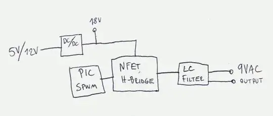

I'm doodling with a future circuit. The application (Commodore 64) expects 5VDC (which I will provide with a pass-through) and 9VAC 50Hz. I do not have any working circuit or a schematic, because the circuit does not yet exist other than as an idea, but I have this very crude block diagram:
enter image description here original
The circuit is fed by an external power supply, with 5V@10A and 12V@10A. I can use whichever I want. Even both. Since I want 9VAC in the final step (~13V û), I want some headroom for the H-bridge. So I pick 18V. That's what I want the DC/DC to achieve for me.
I think I need isolated DC/DC, but I'm not sure. What I'm sure about is that the 9VAC needs to swing around 0V, so no DC-components or offsets on it. With isolated DC/DC, I'm hoping (yes, because this area is completely out of my league) that the 9VAC will look like any 9VAC wallwart would produce. At least, that's my goal.
The 9VAC is supposed to be able to deliver 750mA continuously, so I will design for 1A. Bonus is if I can manage to double it.
There's a lot of new things here for me, so I need to break things down to make them graspable. At this point, I will put the PIC/Bridge/LC aside for a while and focus on the DC/DC.
Questions:
  1. I know MAX1523 will work here, but it's way too expensive. Will LM2735 (datasheet) be of any use for my design?
  2. What part(s) in my block diagram are responsible for the maximum amps at the outputs? The DC/DC, the H-bridge, or both?
  3. Flyback topologies seem to use a transformer for isolation. Datasheet for MAX1523 suggests using a dual inductor with ferrite core (to save space). If this sort of isolation is used, will the 9VAC output be of the type I want (no DC-offets, etc)?

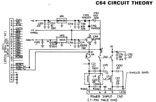

OK, from the service manual, here is the circuit you're driving:
C64 power input circuit
Since the 9VAC is used to feed a voltage doubler in order to produce the +12V bus, you do indeed need AC. However, the waveform is not critical — a square wave (with some filtering to eliminate RFI) would work just as well. Also, the frequency is not critical either, unless something connected to the "User Port" cares about it.
So, I'll modify my previous comment. You could just feed pins 6 and 7 with complementary square waves that swing between 0V and 12V using your H-bridge, and the circuit will be happy. No need to boost the voltage, and no need for isolation. Nothing will be damaged.
The "+9 unreg" rail will be close to 12V, but that's the nature of "unreg". It probably was that high anyway, assuming the 9VAC input is an RMS rating.

  • Ain't the 50/60 Hz AC used for scan line syncronization like on the Amiga? – winny Feb 07 '19 at 15:10
  • @winny: You are right. Reading the service manual that Dave Tweed linked to, I see on pdf-page 26 that the 9VAC is indirectly feeding U27, which creates a 50/60 Hz square pulse into pin 19 of the CIA. Pin 19 is described as "Time Of Day" (pdf-page 25). I tried to simulate U27 using a 12V square pulse but the output pulses were way off (2V - 4.5V instead of 0V - 4.5V as for the 9VAC input).
    So it seems I will still have to make a sine wave after all.
