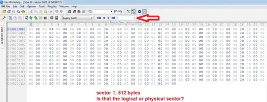

I'm using Hex Workshop software to check the content of each sector of the card, in the picture below I stored 1,2,3,4 + 508 bytes with value 0 to the sector 1 (and I'm able to write the same sector again with new values without using any erase operation in my code), BUT I don't know if that's the physical or logical sector that's being shown on the software...

Hex Workshop shows this

  • Thanks for your answer, I didn't understood your reply so well, I think now I have even more doubts. I've edited the original post with a related doubt, could you help on it? I'll read about wear leveling trying to better understand your reply and return later. Thanks. – abomin3v3l Feb 04 '19 at 17:26
  • @abomin3v3l it's not really permitted to expand a question after it has been answered. Also your expansion seems to miss the key point of this answer - the card won't let you at the actual physical blocks, as what the interface present as physical blocks are actually above the flash translation layer. And while the flash translation layer may seem to make life simple, it also introduces a point of failure which is out of your control - if the FTL built into the card gets confused, you can loose the whole thing, not just the block or partition you thought you were operating on. – Chris Stratton Feb 04 '19 at 17:40
    @abomin3v3l As Chris Stratton says, the memory controller on the card will not let you see the 'real' physical blocks. When you send a write command to e.g. the 'logical' block at address 0 the card's controller will select some physical location in the flash memory to put the data into. When you write to that 'logical' location again, the controller will likely select some other physical location of memory to store the data. You have no way to know or influence where on the chip the data actually resides. The confusion may come from the fact that e.g. an operating system will refer to the – JimmyB Feb 05 '19 at 09:07
    card's interface as physical blocks, as opposed to the logical blocks and clusters of partitions and file systems. But internal to the card there is the memory controller which, invisible from outside the card, will re-map what you or the OS sees as 'physical' blocks to varying locations in the actual flash chip. So a 'physical' block as seen from outside the card is not really a (single) physical location on the memory chip. – JimmyB Feb 05 '19 at 09:10
    @JimmyB Now I understand what you said in the previous replies. Thanks for your support. From yesterday to today I left the MCU writing continuously to the sector 1 of SD card, it were 1.1 million writes to the sector 1 and I'm still able to write data correctly to sector 1. The card is new (SanDisk) and there many logical sectors that were never writen. As my understanding now, the less number the logical sectors I use, the more space will be available for wear leveling. – abomin3v3l Feb 05 '19 at 10:42
