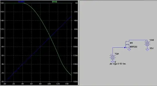

The resistor is needed; otherwise you'd have no way of getting a logic 0/1; also, in this case, when the MOSFET is on it shorts Vs to ground.
E.g. in the example below, the blue line is the input voltage (Vin) and the green line is the current that the voltage source (Vs) is giving. As you can see, the current reaches extreme values.
Example curves

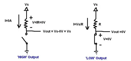

But if you turned the switch on, what would your state be? You need the resistor to keep the Vs from shorting to ground and to give you a defined 0V when the transistor is on thus the inverting property.
EDIT: go look up 'ohm's law'. Looking at the image below, for the "LOW" case, where I=Vs/R, change R to 0ohms and tell me what your current is. Or for an empirical experiment, go short your car battery terminals together or stick your finger in a socket.
